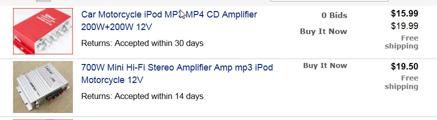

Many class-D amplifiers on e-bay are 40 Whats which is really only 11 Watts. They use an obsolete Tripath IC (they went bankrupt 4 years ago) or a Chinese copy of it.

Edit: I would never buy a "mini" motorcycle amplifier without any detailed spec's. Is 700 Whats actually only 11 Watts?
EDIT again: I don't know why Digikey (North America's largest electronic parts distributor) doesn't have any.

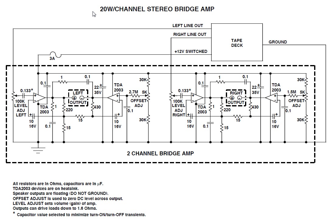

You can build a pretty decent bridge amp using the TDA2003 IC audio amps. Still lots of them around CHEAP. Here's 75 pieces new for $20:
Or 10 pieces new for $12:
I have a schematic for a DC coupled bridge amp for these designed to run off 12V. I ran it in the back of my Dodge for a lot of years.

His speaker is rated at 40 Whats (peak or peak-to-peak for only a moment?). Its continuous power rating for a sustained chord might be only 10 Watts or less.
RadioShack sold the Minimus 7 speaker which had a 4" woofer and a dome tweeter in a sealed cast aluminum enclosure.
I bought two and they sounded great. They were rated at 40 Whats each. When a woofer disintegrated I took the speaker apart and it was stamped "Korea nominal 5W, music 10W". The RadioShack replacement woofer was stamped "Japan nominal 5W, music 10W".
