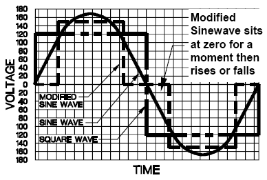

Audioguru's schematic isn't PWM, nor a tuned output inverter. It has "modified sinus" title on it.
A modified sine-wave is a square-wave with a step in it like this:
One way of producing a modified sinewve is to use a DC-DC converter to boost the 12V to 320V DC then add an h-bridge to the output. Many cheap lightweight inverters use this technique. If you build an inverter with more than one output voltage you can have multiple steps in the output waveform which will reduce the harmonics even further.
