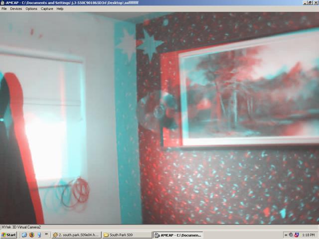

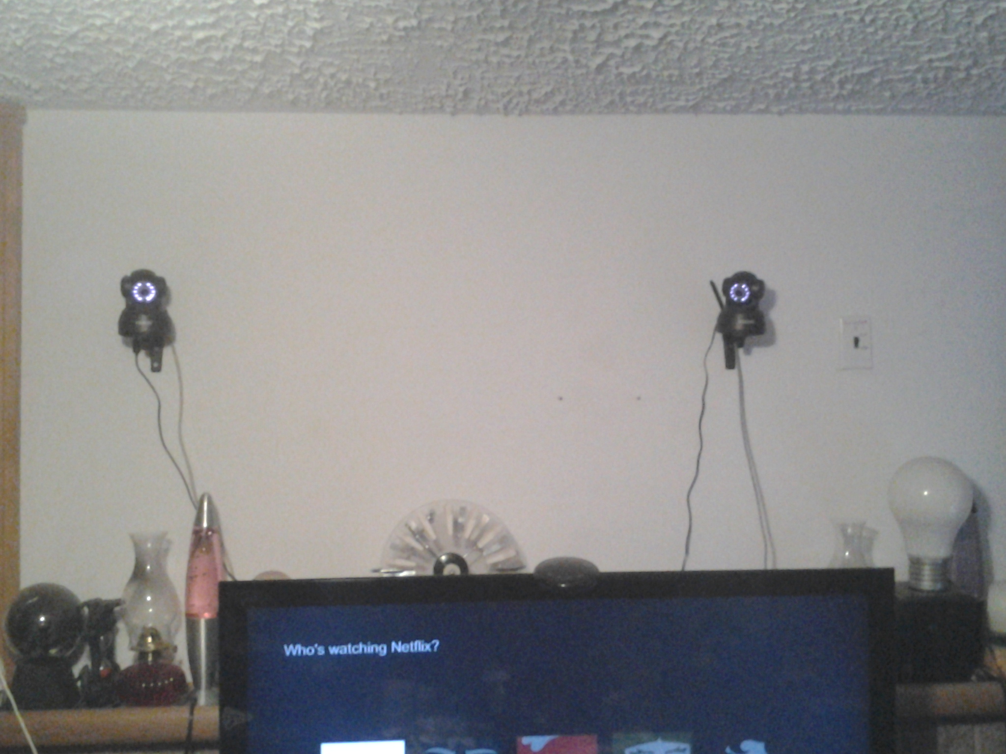

photo 1 & 2 are two cams mounted on the wall, unaligned at the moment, but with i little software was able to design this first stereo image(look close you will see a CD hang in the center of room), when i have time ima try to re-encode it so instead of Red/Blue it will work on 3d full color tv.

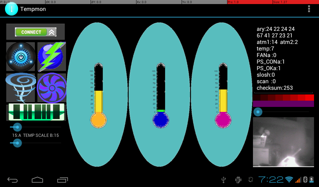

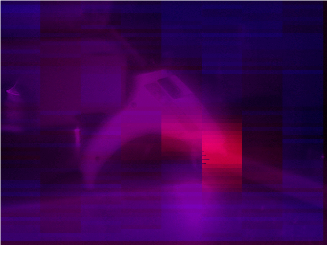

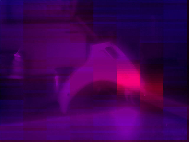

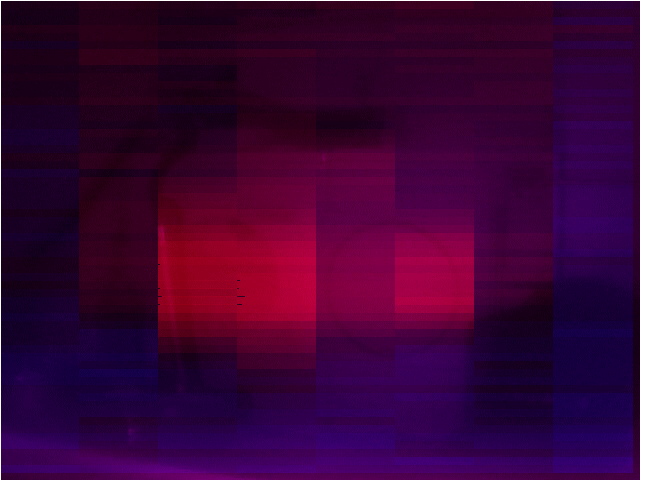

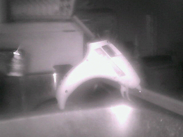

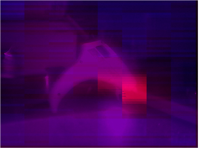

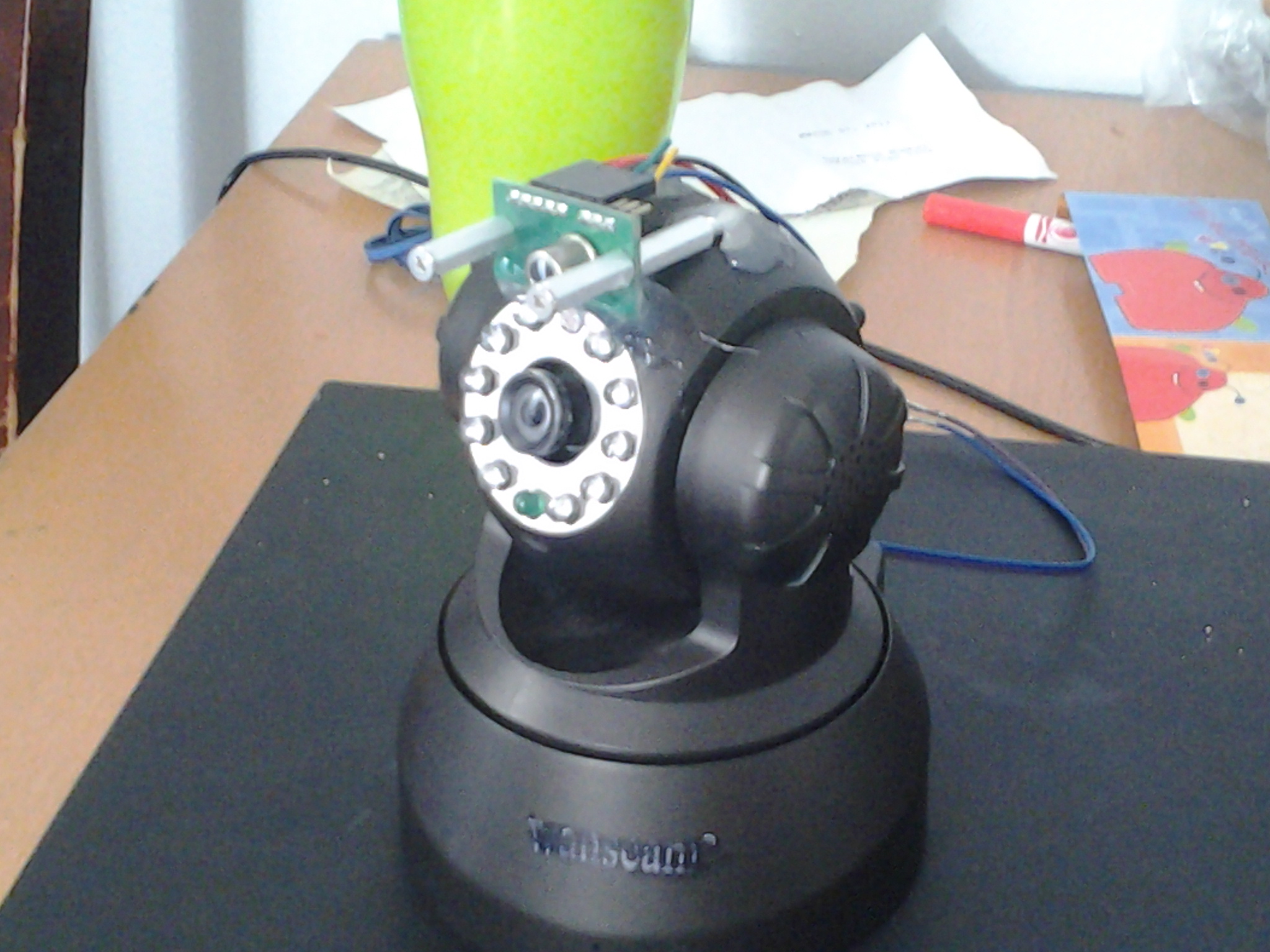

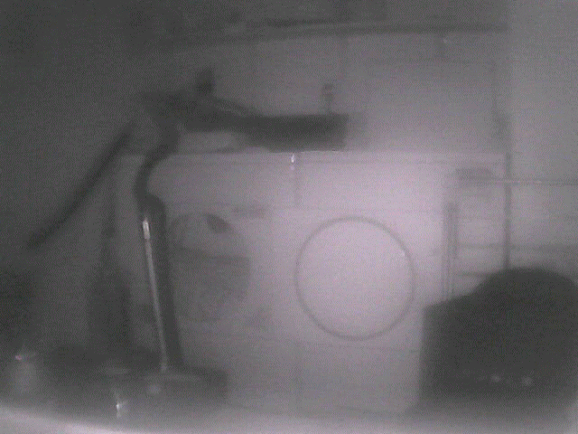

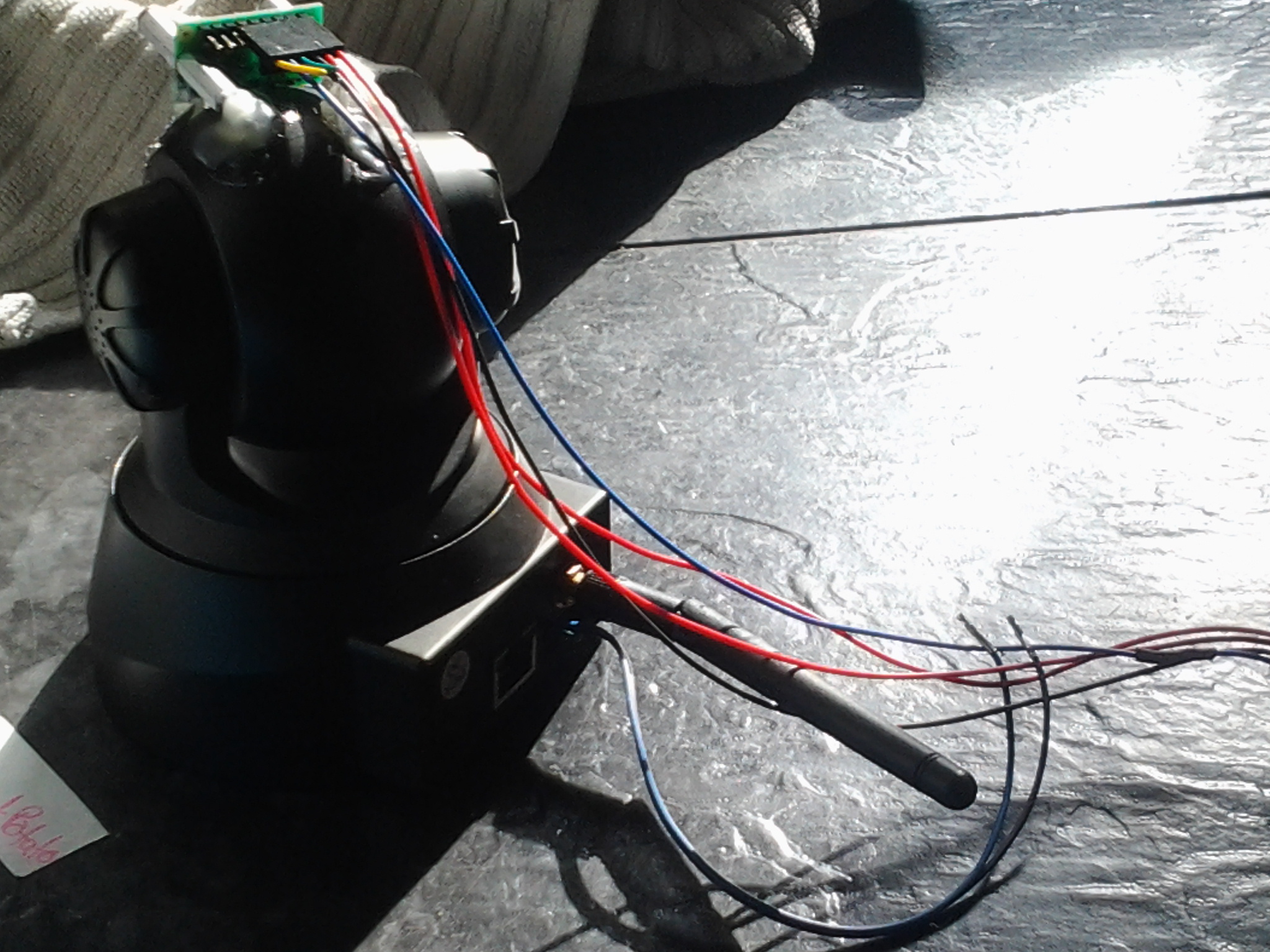

here is a $100 TPA81 hot glued and aligned to the bottom horizontal pixels, i have also opened up the camera and found a port for incoming only 232 data (from web, to cam , to data wire), so with a little android code i created this platform, with various other components, but you can see the camera image in the bottom right, and sliders to zoom in on thermal range as well as zero, default at ambient, unfortunately as i said cam is only one way so micro-controller controls are using Bluetooth:
https://image.dhgate.com/albu_291350939_00/1.0x0.jpg
scan takes about 1.5min, but only since i have scan wait until webcam has responded through web that it receives command..
thought you guys would like:)

TY!YES, it works with the red/blue 3d glasses in that image, the magic is in the software: "HYTEK stereo 3d camera driver", the 3d is compiled with 2 cameras, the hard part to it all was aligning horizontal, tilt, and the focal points.
the first cameras i bought were wanscam, the one im using for thermal is the first one i pulled apart and found the data line, also the image has never been as clear since i accidentally washed off the purple filter on the lens.
then i bought another later on , it was an "EasyN", there were subtle differences in the cameras and they are both knock off's of the foscam cameras, but i found the wanscam to be a bit better.
ebay btw
ill try to get a few true 3d shots with the newer 3d types soon, now that they are mounted...
