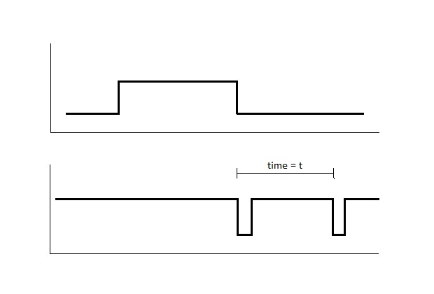

I am attempting to create a circuit that generates two negative pulse signals separated by some amount of time. The trigger for the first pulse, however, is a switch, who's initial state is 'off', turning 'off' after being 'on' for some amount of time. I have attached an image to show what I mean.
The actual situation is that the switch is on a kettle and the two pulses need to be generated when the kettle has finished boiling, i.e. the switch has turned off. These pulses are going to a monostable multivibrator.

If time t is more than a few minutes, it is not practical to use analog RC delays. I would use a 4017 CMOS counter and oscillator made out of gates.
How long is t, and how long should the pulses be?
Time t is of the order of a few seconds and the pulses need to be about 1-5ms in duration.
So just to be clear, you want the first down-going 5ms pulse right after the down-going edge of the input, and the second down-going 5ms pulse an adjustable delay (1 to 10sec) later?
What voltage do you want to power it on?
What is the amplitude of the input pulse?
What do the two output pulses drive?
That is correct, however it must not generate a pulse when the input goes from 'low' to 'high' , only 'high' to 'low'.

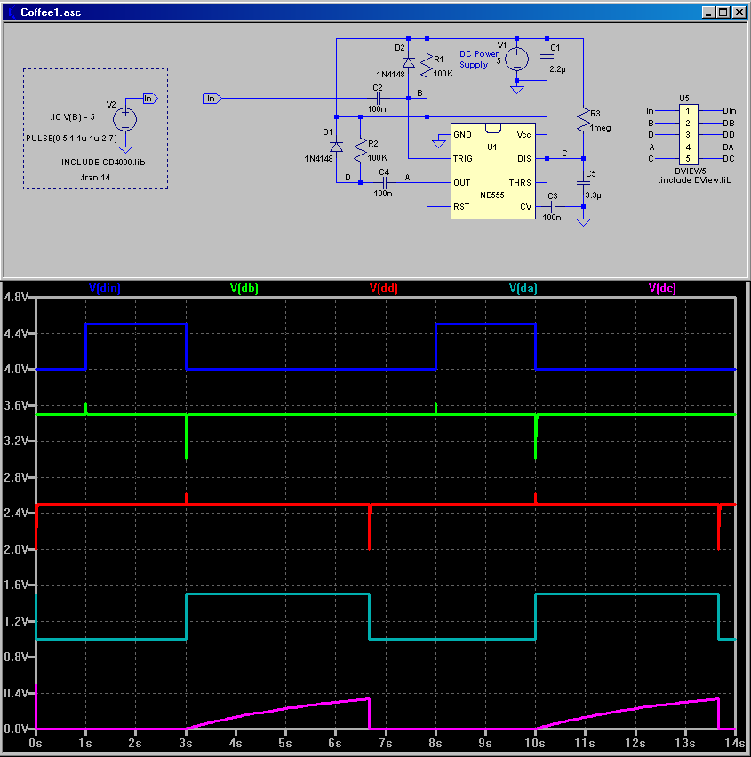

Maybe this is what you want: Look at the light blue trace V(da), which is really the voltage at the out pin of the 555, node A in the circuit. Is that what would control your PWM stage?
Otherwise, the two pulses you requested are V(db) and V(dd), nodes B and D in the circuit, respectively.
They are all really 5V signals; it is the DView gadget that compresses the traces and spreads them out so they dont cover each other up.
