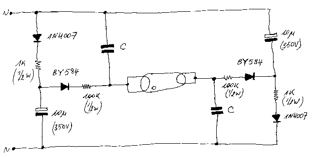

Thats a clear, understandable drawing, it dosn't give me a problem....;)
The diodes, resistors and capacitors are clear.
What is the scribbled thing in the center? A hammock?

The BY584 diodes and the working voltages of the capacitors
should indicate that there are high voltages present. If you apply
230 volt ac to the circuit you will find that there is 1300 volt with
the 230 volt line voltage superimposed across the hammock.

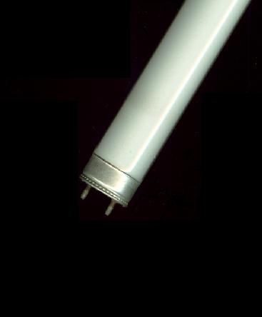

If you haven't guessed it by now let me give you a clue.
on1aag.
on1aag said:
Hi Audioguru,
on1aag.
It was obviously a gas filled tube, ref the small circle in the 'hammock', just didn't want to suck all the fun out of it..:D

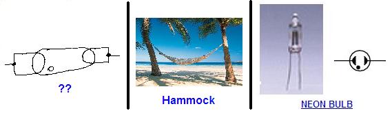

I thought "the hammock" was a neon bulb since it wasn't labelled.
It was posted as a very clear GIF file type.

Regarding the hammock; I only knew it was a fluorescent tube because I've seen the circuit before. The diodes and electrolytic capacitors form a half wave voltage quadrupler which generates a 1.3kV spike which ignites the tube. Once the tube has been lit the non-polarised capacitors act as a ballast and power the tube as normal.
There's no voltage or frequency on the power supply so I assume the circuit runs of 230AC as the electrolytics are rated for 350V.
The ballast capacitors aren't labled there are no component designators.
Unless you only want to dimly light a tube this circuit isn't very practical as to even light a 4W tube at full brightness the ballast capacitors will need to be 5:mu:F which is quite a large at they'll need to be rated at 120VAC.
