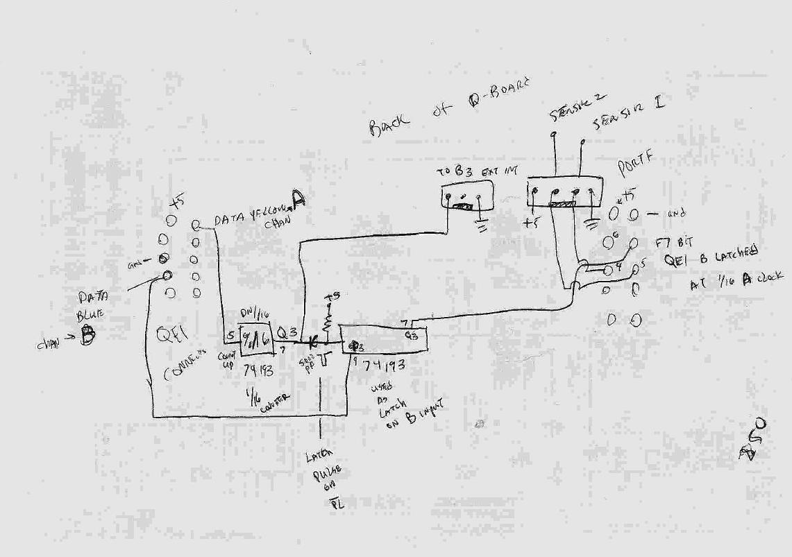

One of problems was the high resolution QEI encoders on some of the digital position feedback systems as some were up to 360,000 counts per revolution. For testing this precision was not needed and at high speed the PIC couldn't handle the interrupt load easily so a simple divide by 16 counter circuit for the A input and latching for the B input was used (both 74193 chips from the shops misc parts bin). At every 16 counts the divided A would latch the full count B signal and send an external interrupt to the controller to increase or decrease the internal position counter from the current latched B bit on the input pin for 1/16X positioning.

Hand drawing of the circuit from the project notes.

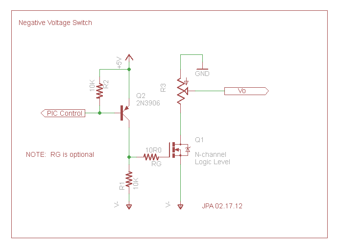

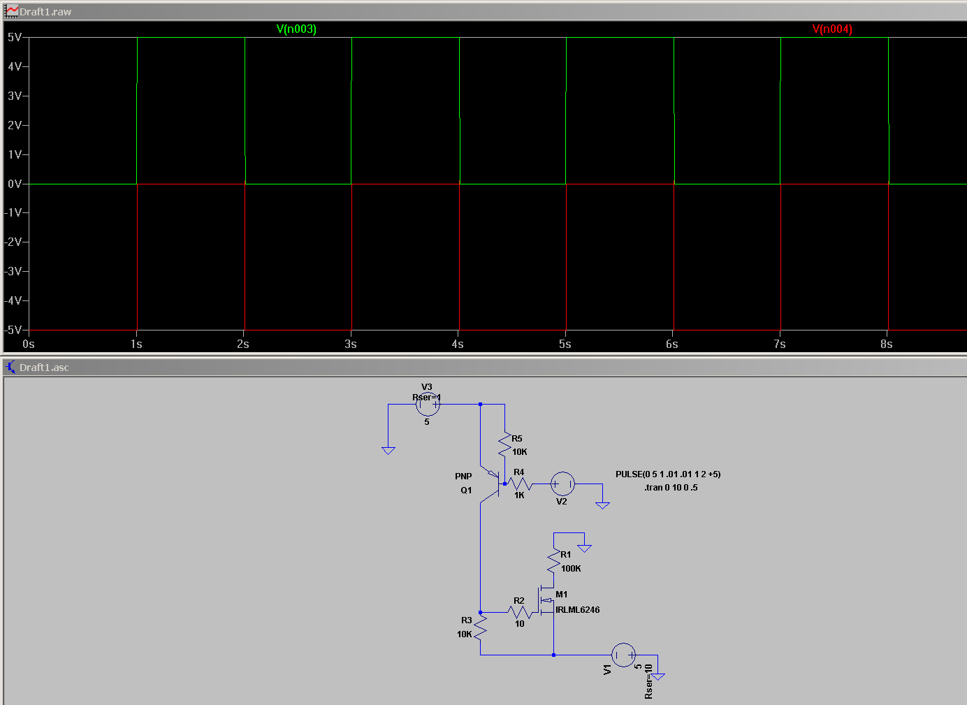

The datasheet for a GLCD I was using had very specific recommendations for timing and sequencing the negative bias voltage, namely never allow Vee to be present without Vdd. So, I looked for a negative-voltage switch. There weren't a lot of options, but based on what I found, I came up with this circuit:
The asc file is attached below. Here is an image of it:
The green trace is taken at the base of Q1 in the simulation schematic; the red is at the load. NB, the component numbers are different in the simulation from the schematic posted above.
After discussion on ETO, others convinced me that such timing was not critical. I ended up using just a negative-voltage generator with an enable pin. A simple delay was used to allow the voltage to decay before turning off the positive supply. The value if R1 in the schematic above is not critical. All you need is enough Vgs differential to turn on the mosfet. The circuit will simulate without the transistor(Q2) and a voltage divider, but then, the divider resistances become very touchy.

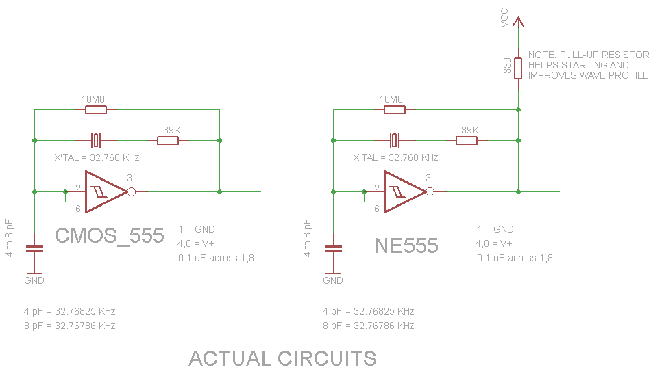

The second circuit came about as sort of a tacit challenge. It is often stated that the LM555/NE555 lacks frequency stabiltiy. I don't think that is a fair criticism. It is like any other RC oscillator. Bill Marsden (aka QuietMan on ETO) is fond of representing the 555 as a Schmitt innverter. One of my favorite application notes is from Fairchild on CMOS inverter oscilators (https://www.fairchildsemi.com/an/AN/AN-118.pdf). So, putting 1 and 1 together, I came up with a crystal-stabilized, 555 oscillator:
I don't believe this has any real use, unless one has a box of 555's and no simple Schmitt inverters.
