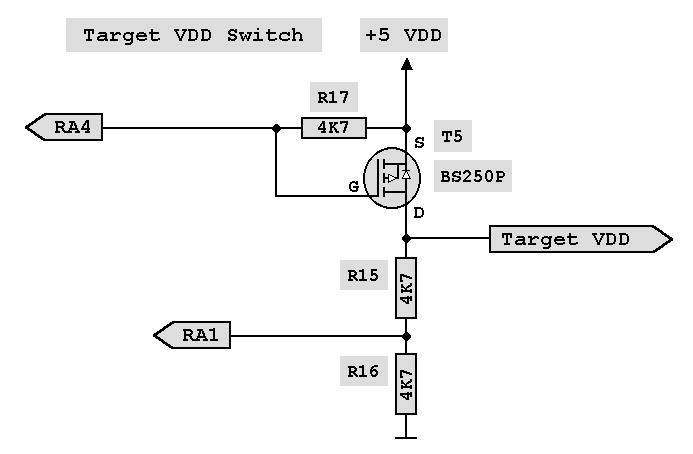

Do you guys think the 16F88x will have the same issue as the 16F88. By this I
mean the internal OSC and MCLR when used in a certain combonation, it will
cause a conflict and make erasing difficult?
Gordon

That's only a problem with programmers that don't fully control VDD and VPP to the target PIC. My melabs Serial Programmer doesn't have a problem with those chips using that configuration.
Actually, my Serial ICD2 clone (modified Stolz design) was able to reprogram a 12F683 in that configuration (INTOSC & MCLR off). Not sure if it was because I added VDD switching circuitry or not but it worked.
Good luck. Regards, Mike

I didn't want to add the switched VDD circuit because I didn't want to add a 1A switch.
That's the reason, the only reason the InchWorm can't do it is because it doesn't switch Vdd - but it's not a very common practice for ICSP.
I didn't use a 1-amp VDD switch, just a little BS250P P-channel MOSFET in a TO-92 package.
I suppose a jumper could be added to take it out-of-the-circuit and select your always-on VDD power source.

if i'm using inchworm design (modified stolz) that take 12.5v from max232, it's work to add BS250P P-channel MOSFET ?..
Could someone please tell me why it is necessary to switch Vdd?
I did not bother doing it in my programmer but I have only ever programmed 16F devices.
Some devices (like the 16F628) allow you to allocate the MCLR pin as an extra I/O pin, and can use an internal oscillator - giving 16 I/O pins on an 18 pin package. As there's then no reset pin you can't reset the PIC in order to access programming mode, so you need to switch Vdd OFF to stop the PIC running, THEN reapply Vdd and VERY quickly switch MCLR to 13V, BEFORE the internal oscillator can start running.
So if you don't switch Vdd, have allocated MCLR as an I/O pin, and have enabled the internal oscillator (as my tutorials do) then you can't program the chip after the first time.
