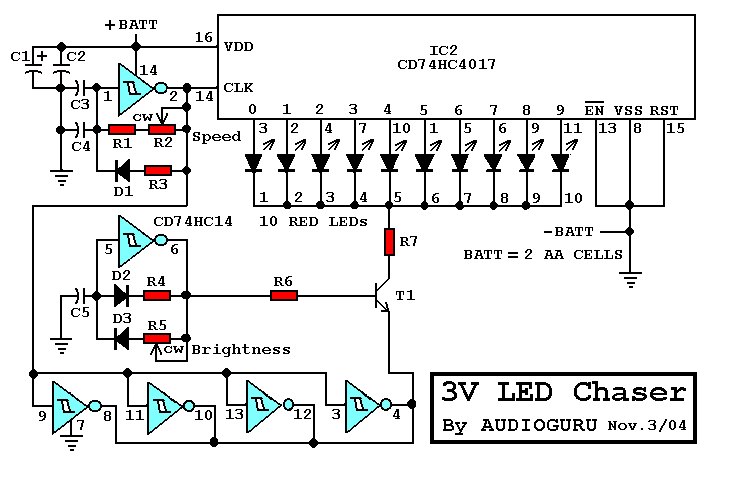

Hi Diroga,
Zach is right. AA cells last much longer than a 9V battery. Have you seen the tiny size of the 6 cells that are inside an expensive 9V battery?
I have a chaser project that blinks bright LEDs in a circular sequence. It uses 1.7V to 1.9V red LEDs and only 2 AA alkaline battery cells that last "forever". It uses a 74HC14 IC that works down to a voltage lower than the LEDs need and the LEDs are still pretty bright when the battery needs replacing (2V).
I use a diode/resistor to make a short (30ms) "on" duty-cycle for the LEDs to conserve battery power.
You could make a simple oscillator from 1 inverter of a 74HC14 like I did but dispose of its speed control. The rest of the inverters can be paralleled like mine and used to drive a transistor more powerful than mine, to drive all your LEDs. You can also dispose of the inverter that I use for PWM brightness control, and dispose of the 74HC4017 sequencer.
Using 3V to 3.5V ultra-bright LEDs and a 4-AA cells battery (the max supply voltage for the 74HCxx series is 7V), it can be seen for miles and is awesome! My schematic is here:
