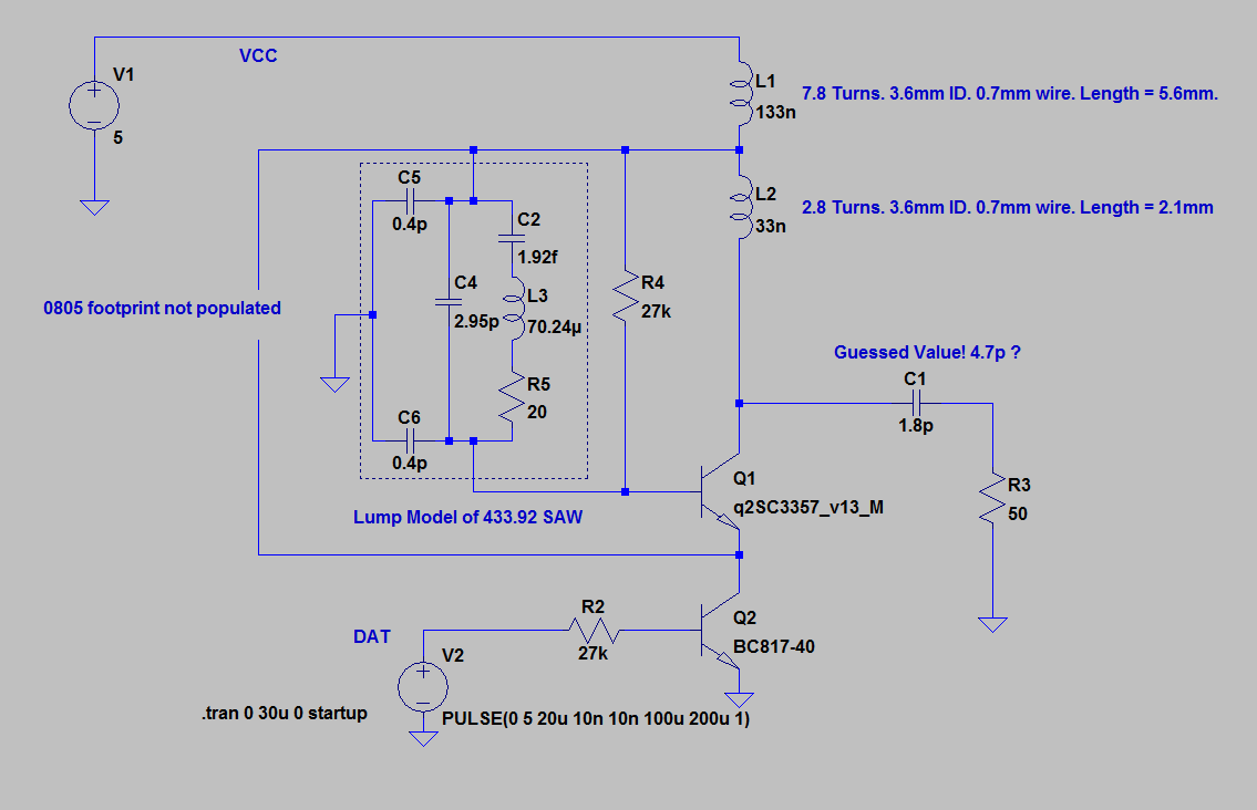

Now, I am having issues with the transmitters from the first link. They are deceptively simple, and despite using a 433Mhz resonator, I suspect their frequency isn't particularly accurate, nor is the output power controlled well. Essentially, one of my transmitters works (with the maplin Rx) very well. With a stubby antenna on the tx, a helical antenna on the Rx, I can get 60m+ range, without errors. However, the other transmitters don't seem to communicate at all with the receiver - that is until .....I touch one of the coils with my finger. Whilst I am not exactly an expert on RF, I know this will add small capacitance to ground

A schematic found on Google of the tx - with different values, and C1 is not populated on my board, but this is more or less it.
http://www.hobbycomponents.com/images/forum/MX-05V.jpg
The only way this will transmit anything, is if I touch the larger coil, on the schem, that is L1, which is 7-8 turns, going from VCC to the oscillator.
My question is, although it is a rather crude oscillator, could it be that me touching the coil adds enough capacitance to 'detune' it back to 433Mhz? And as it *appears* that this coil is just feeding power, is it simply a filter, so decoupling the VCC to ground would provide more accurate frequency?
I am just unsure why one of these transmitters worked so beautifully well, but the other 4 I have all exhibit the above behavior, even though all the values appear to be the same. I don't have the facility to measure the frequency output of these, only real test I have available to me is using the stable Rx as an indication.
Any analogue guru's who knows pierce oscillators please chime in :) They are so cheap I should just buy 'better' ones, but curiosity got the better of me, I like to know 'why' things are inconsistent :)

Just wanted to point out the transmitters aren't tunable, no tuning caps, in fact, the only cap on it is the coupling to antenna, then its two inductors, SAW resonator, two resistors and a transistor!
If you believe in the SAW, then you will have a hard time pulling the transmitters very much. Since you are using superhets, then they have a much narrower bandwidth, and the transmitter must match the superhet receiver. Surely, the mfg. of the superhet sells a more accurate transmitter to go with it. You shot yourself in the foot by buying the cheapo transmitters and using them with an expensive receiver.

Well, now I have decided to go with a better transmitter for any more of these units my customer wants, I'm stuck with 4 x tx/rx pairs to play with! As an exercise in RF design/debugging, I'm trying to simulate the tx in LTspice - not the best software for that task, but seems to be sufficient for checking if it oscillates and what frequency. Using a combination of measuring, tracing, and yes.. guess work... I believe I have a half decent schem of the FS1000A transmitter:
This only includes parasitics of the SAW itself (the two 0.5p caps to ground). I suspect these modules actually rely on the parasitics on the PCB to get it to oscillate.... The output of this is anywhere from 800Mhz to 1.1Ghz, although with the above values, 883Mhz (close to 2nd Harmonic of 433?) seems to be the peak.
Took a lot to get it to oscillate, seems this crude incarnation in LTspice requires a load, and the output cap to be 1.5-4pF. I noticed on one device, if I put a 5pF ceramic cap in the 'unpopulated' footprint, the transmitter worked well with the superhet receiver - but *only* when no antenna was attached. As soon as I put a 50-ohm stubby on there, the receiver stopped getting anything. As the output is directly from the collector I'm guessing it is very easily pulled off frequency.
It is odd, most of my googling showed the most common version of a 433Mhz SAW transmitter is a colpitts oscillator, this appears to be a pierce, one that isn't well designed. I could just take the SAW resonators out of these and knock up my own 'better' transmitters, but would be nice if one could work out a matching network, or at least some tweaks to get these to have better frequency stability - be it replacing the inductors with SMD, adding shunt caps etc.. I'm out of my depth, but the first step is knowing how and more importantly *why* these work, then some mods to see if they can be improved - or at least tuned.
