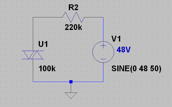

I'm using a Diac (DB3) in a simple circuit to study its behavior. The schematic is attached. The output is not what I expect! The break over voltage of this Diac is 34 volts.
The time the input sin wave is less than 34 Volts, The diac is off and the output is the same as input. when the intput voltage exceeds 34 volts, then the diac turns on and so the output should be zero!!!! but it's not in practice.
What I see on the scope is the constant 34 volts while the diac is on. Why's that? I can't figure out!!!!

You should have a capacitor across the diac.
If the supply is DC
The voltage across the capacitor will rise (as it's charged up through the resistor) untill it reaches the turn on voltage of the diac.
When the diac turns on the capacitor will discharge.
The process will then start again.
If you have a supply of over 100V DC then you can use a neon bulb instead of the diac. The neon bulb has a turn on (break down) voltage of about 90V
The circuit can be used as a simple way to determine the value of an unknown capacitor.

I suspect that the 220K resistor is current starving the diac, so it cannot go into a avalanche state, also whats the output
resistance of the voltage source?
Usually the diac has a low value capacitor across it, and it 'dumps' the charge on the capacitor into a load, or triac gate.

In a lamp dimmer, its very important to get the resistor and capacitance values correct as the diac has to trigger the triac within the half cycle of the AC supply. The values will be dependant on both the voltage and frequency of your AC supply.
It's best to build a circuit that works then you can experiment.
A voltmeter is unlikely to be of much help in this application.
The dimmer circuit needs a minimum load otherwise the triac will not conduct

In the responce to other firends, as you said my problem was the capacitor and the resistors that were somehow large. Thanks for all for your assistance.
