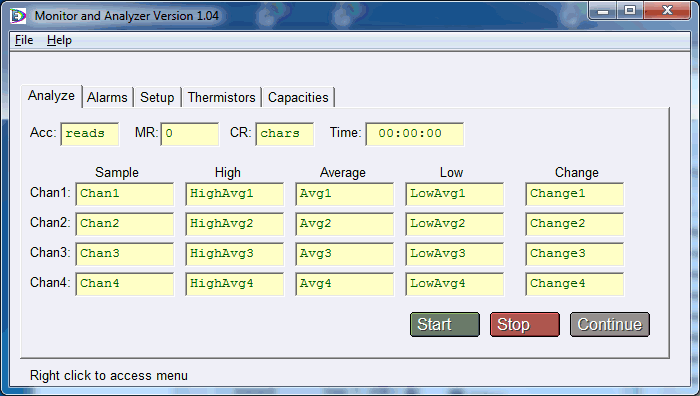

Here's a quick screen shot of one of the Windows graphical interfaces, just the basic type...
