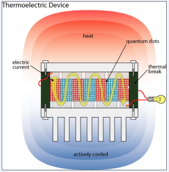

I was wondering how they did that then it hit me -- Quantum dots ..
The quantum dot thing is a theoretical proposal. The actual devices out there use junctions of P and N material.
