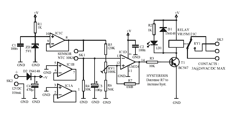

Ok, I found this, **broken link removed** and supossely with a few modifications it will work with the temps I am wanting to regulate. Here are the mods, tell me what you think.
There are 4 resistors to change, R4, R5,R6, R7.
Change to
R4-4k7
R5-3k9
R6-2k7
r7-10M
1k horizonal potentionmeter-UH00
Now if someone wants to take a look and see if this will work for the thermostat, to keep temps in the 99.5 degree range. I would appreciate it. We can work on the digital later.
Do you have a schematic? Hard to advise parts values based on a photo of the kit PCB.
But it does look like a comparator thermostat with a relay. I'm sure you can fiddle with the resistors to set the temperature range you like.
It's a very simple comparator temp controller.
Just hook it up, you will probably find the adjustment will already reach your target temperature. If not just change R5 or R6 so it does.
And it might need the temp sensor fairly close to the heating element.
