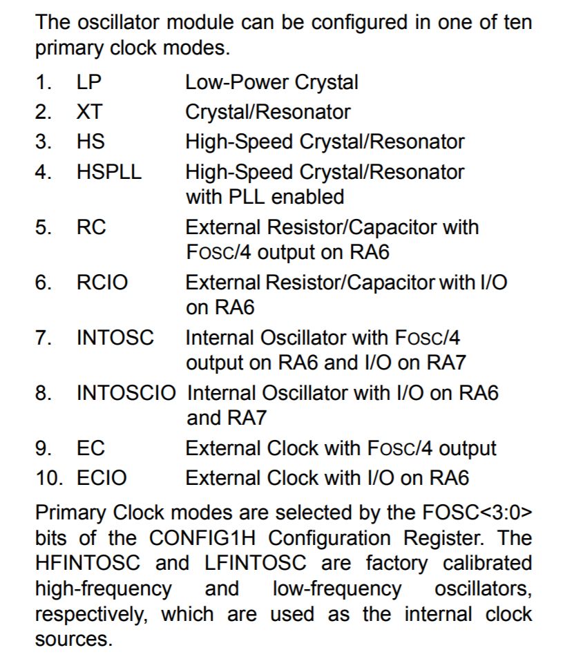

I tried to compile what I had listed. Apparently, the 18F23K20 doesn't follow the same parameters as the rest of the K-series. Not "every line failed" but 6 of the 17 compiler directives have errors. They are commented out in the first column in the code shown below.
So what does this mean? Either the compiler directive has a different name in the K20 devices, or it has different allowable values. How could we figure that out? The smart money would be to look in the data sheet.
FOSC is the oscillator mode. Looking in the data sheet gives us 2 clues:
o HSHP isn't an allowable mode for the K20
o The PLL is configured in the FOSC section rather than as a separate parameter.
The smart money is working your way through the list and setting the parameters correctly. But you, I and everybody else here knows you'll just delete the lines that result in errors and be on your jolly way and it will probably work well enough. Sorry I tried to help and added some confusion. Also sorry I worry about things like understanding why things don't work so I can have reliable code. "It's never done that before" may be ok for your stuff, but it's not for mine.

ran the config gen and now need to do some research into settings. I assume the modules set things up slightly different?
