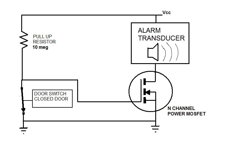

Here is a very simple circuit that will accomplish what you want with a small number of components and with a closed switch when the door is closed.
It isn't precisely how commercially produced alarms work, but it is a good, simple, effective circuit. It might be made better with a P-channel but you get the idea.
And please, don't shortchange yourself because you are young. If you need an explanation please ask.

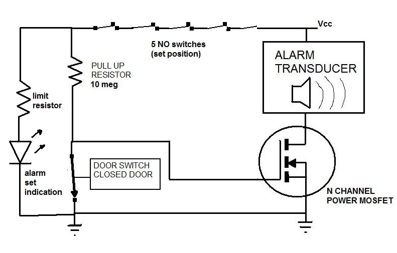

OK, here is the schematic with the "combination lock" switches. Remember, there are 5 of them indicated, per this example, that are electrically connected. Any number more would be added to the panel as decoys or dummies.

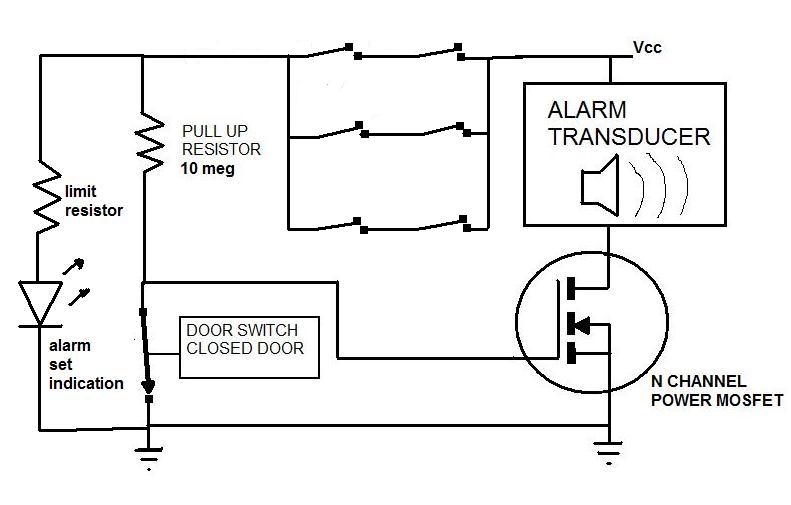

OK, still keeping it simple, yet not SOOO easy to break. Instead of 5 switches in series, how about three parallel rows of two switches each. This way, the entrant has to know at least three of the switches to press to get an open combination. Really, it should have been a parallel combination to begin with. Now that I think about it, two switches aren't necessary for each row,they are only a hindrance for the alarm setter really. And as simple as it is, it does have a couple of obvious flaws.
One, All it takes with the switches in parallel to REALLY set the alarm is one series pair of closed switches. The alarm setter could get lazy and neglect to set the others.
Two, the unauthorized entrant only has to press each switch once to disarm the alarm, as long as he doesn't punch switches randomly he will get it. Now, I would think most people wouldn't realize this when they walk up to, what appears to be, a keypad. I think we have all become sort of acclimated to passcodes that it would be instinctual to hit random keys rather than each switch one at a time. Maybe in being simple and archaic it does the trick :)
Also, another disadvantage is that if someone came up and randomly hit switches and failed to disarm it, the "owner" of the alarm would have a heck of a time getting it disarmed. perhaps a secret master switch would be a good idea.

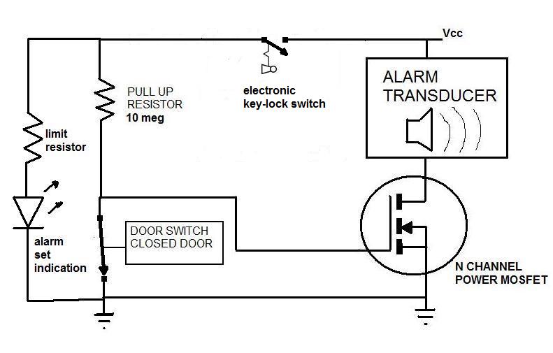

Also, probably better than ANY of these simple, silly combination switches would be a real KEY SWITCH. Do away with all the combination lock switches completely. Get a lock and key switch where when the tumblers are lined up the circuit completes. The owner of the alarm would be the only one with the key. This is how alarms were set before digital panels anyway.
