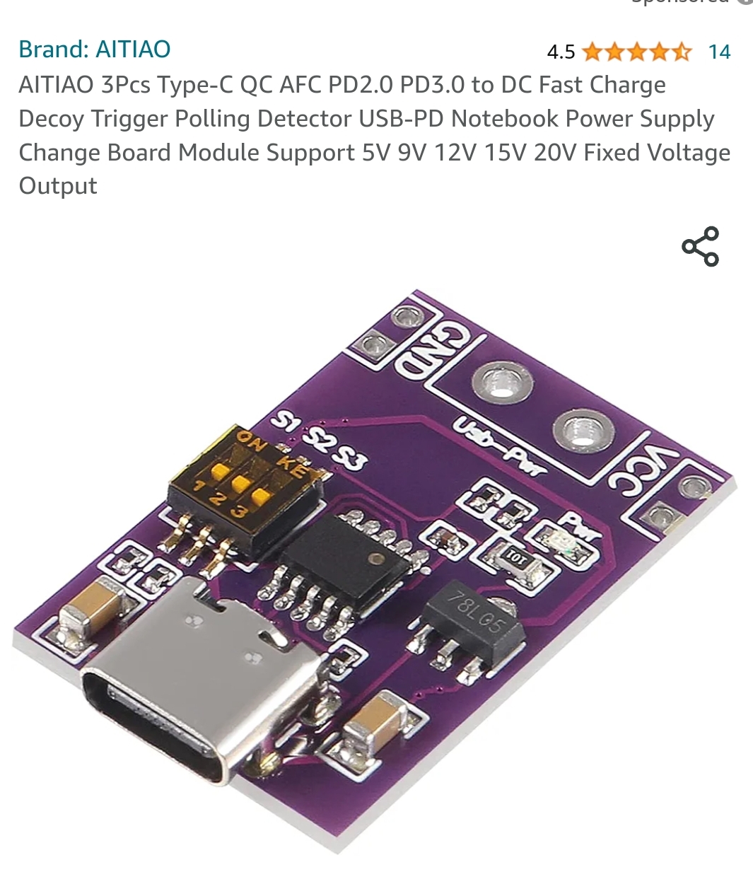

Testing a PD power supply would be simple. Get a PD trigger with selectable voltage selection as shown in the picture and hook up a volt meter to the output.
Extending this a bit further, you could add an in-line USB volt/power meter and an adjustable load to characterize voltage vs load.
I suggest a PD trigger similar to this one. Some types that are scarely bigger than the USB C connector use solder jumpers to set the voltage. A microscope and steady hand is required to make changes on those.
