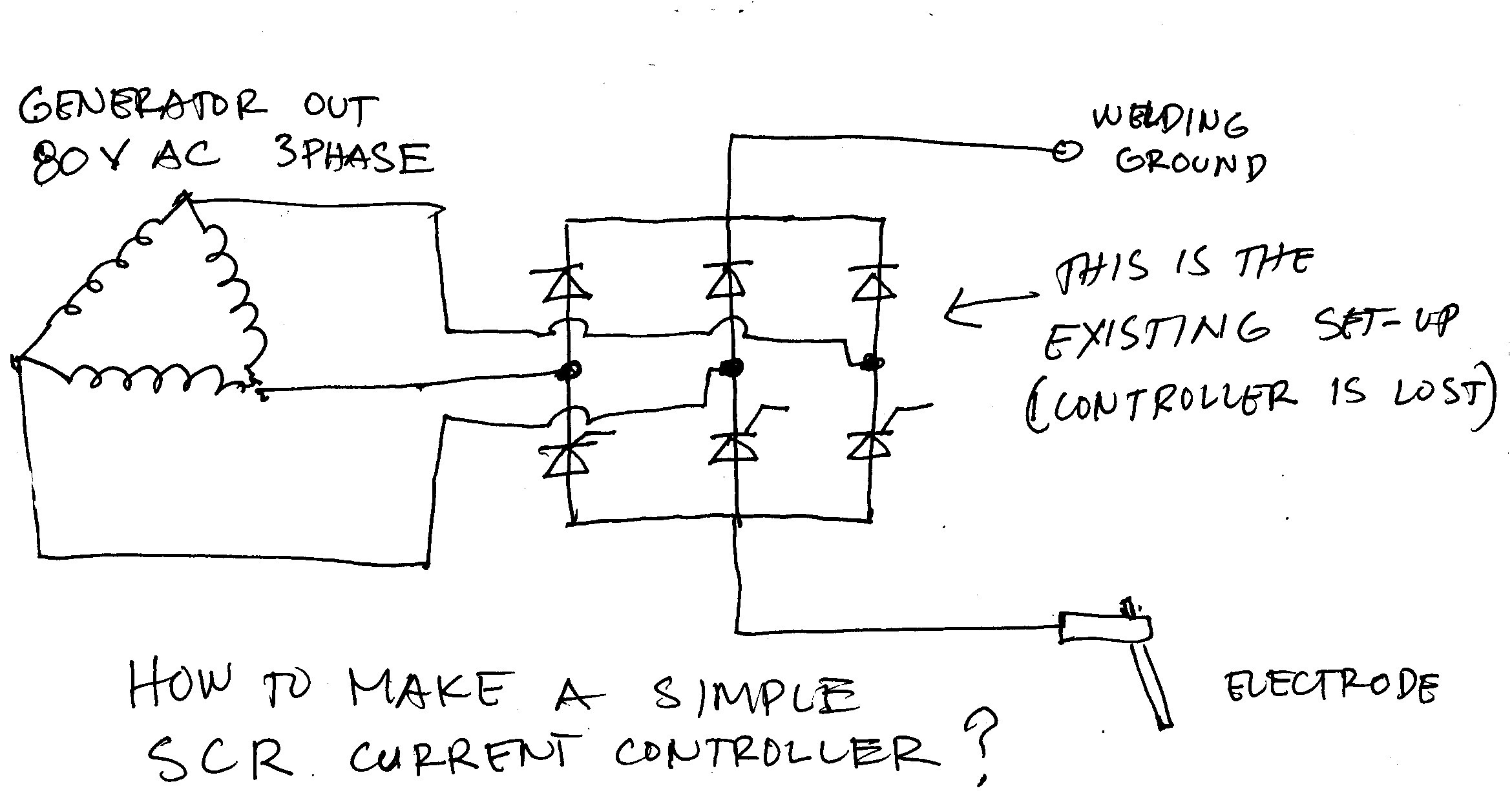

i have aquired a n engine driven welder with an scr current controller. The input is a three phase and then rectified with a bridge diodes. with three negative ground scr. The scr controller is lost. How to make a simple three phase scr controller?

this is my first time in forum. I wonder if my reply to you by using personal message is the right thing to do. or should i use the post a reply on the lower left corner. Any way this is the diagram:
You need to control the phase angle / duty cycle of the SCRs. Basically, control at which point the SCRs should turn on.
The later in the AC cycle that you turn it on, the less average power will make it to the welding electrode. If it is an 80VAC generator, and you get 80VAC out of it when it's running under full load, you can build a circuit to put the voltage into a comparator(using rectifier and a voltage divider) and then set the turn on level by changing the 'reference' value of a potentiometer on the other half of the comparator. You should be able to use one potentiometer to control all 3 comparators with each comparator being fed from a different winding on the generator.
The other method would be to use a micro-controller to watch all 3 windings and do the same thing basically, I think it's too much effort for a phase controller.
At the most, since the SCR's will turn off as they drop past 0 volts on the way to the negative side of the AC cycle, you will be able to control your power between 50 and 100%

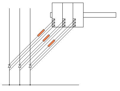

John

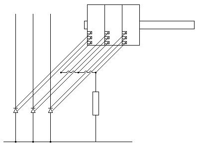

Hey,
Sorry,
I made a mistake with that last drawing.
And i couldn't figure out how to remove it.
So heres the revised one,
Hope i got it right this time ...
John
