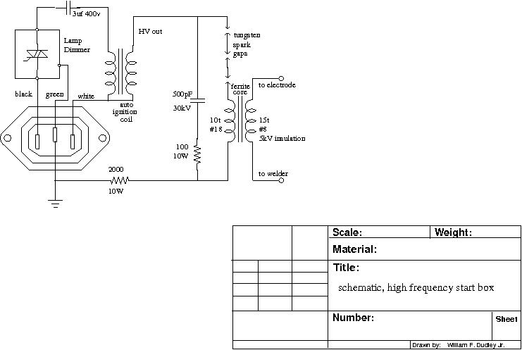

Thanks for the information. I'm still shooting for this design:
but I'll keep that one as a backup. That is useful information thank you for posting it

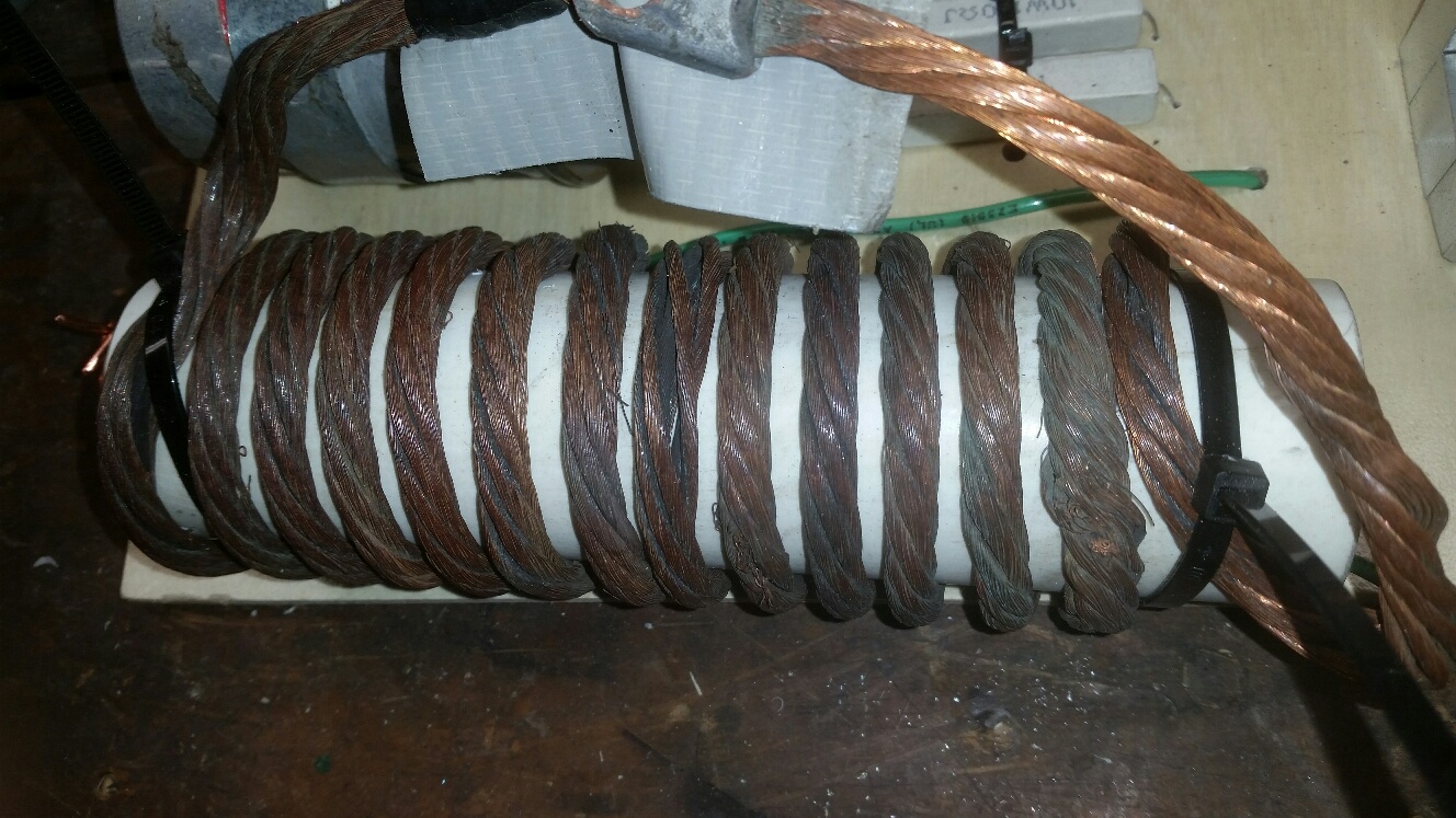

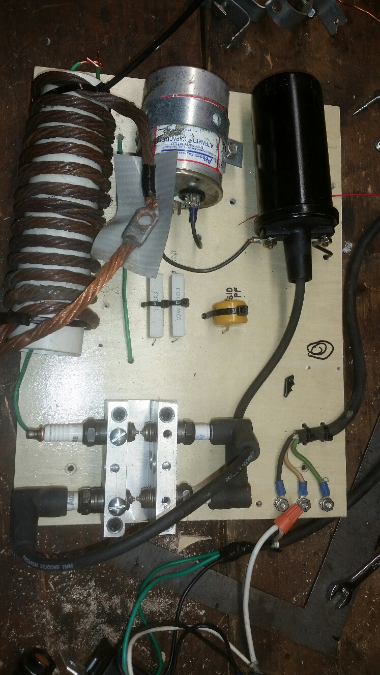

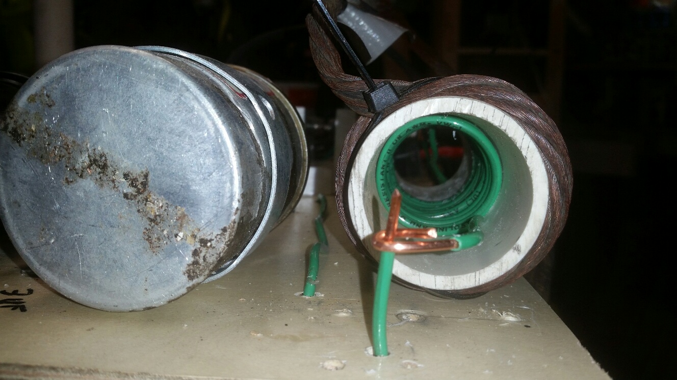

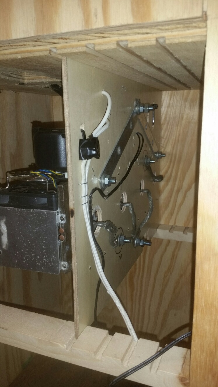

Gentlemen,

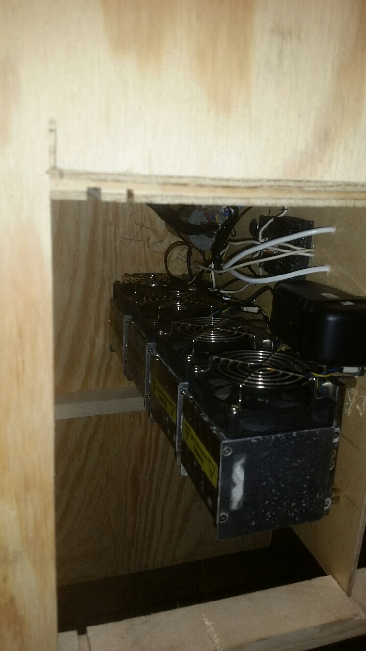

Thanks for all of the information provided to date. I have been a little busy but I did build the circuit I referenced above. It produces a nice spark that has no problem jumping 1/4" or slightly more. I have included pics of the work done so far. Please note that the board was much cleaner before I started troubleshooting it. I really wanted to post a "success thread" with a small MPEG showing the weld actually starting, but I am having the same problem that I had before : I cant induce the HF into the welding lead (or any other wires for that matter. I have tried it with the air core , just like the ones in all of the other HF sections of welders that I have seen and it does not work. I am sure that it is something that I am overlooking. If I cant get this configuration to work, I will try some kind of core next.
I also included pics of the rectifier board and the heat sinks because it came together nicely.
Is there anything that jumps out at anyone that I might have overlooked?

A drawn as built and connected to the welder schematic would be a nice reference for us to work with on troubleshooting.
Seems like a lot of fans for a circuit that shouldn't need more than a few watts of power to operate a well.
The schematic is the one I referenced above in post 30 of this thread, but Ill post it here if you guys need it. Yea the individual cooling fans each have 100 amp diodes threaded into the underside of them, which should also blow on the main welding transformer as well. I also have a larger fan above that will wash air over everything if anything gets too hot. The diodes on the fan/heat sinks could see ?? 220 amps at 20 or so volts so they could share a combined load of 4.4kw ?? I doubt Ill use but about 70 amps normally but its nice to have the capacity if its needed.
The spark gap and 500 pF capacitor need to be switched around with each other.
Also the AC side driver circuit with the single triac and capacitor is still terribly inefficient design that dumps a huge amount of RF noise directly into you home power lines when its running. :(
Lastly if its not superimposing the HF on the work leads you need to have proper blocking and bypass circuits on your leads between the high current DC source to stop the HF from feeding back to the diodes and to give it a path to follow from one work lead to the other.
