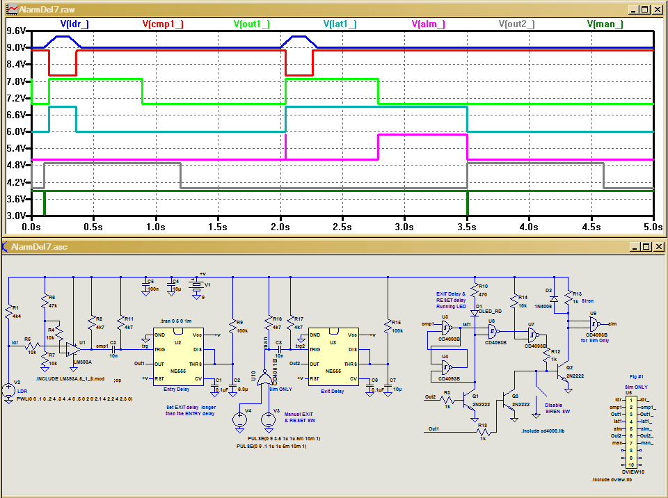

This is a working version of the entry/exit timer for the IR/LDR beam break.
Breaking the beam would set a latch and trigger an entry 555 monostable.
If at the end of the timing period you have not RESET the system the alarm will sound until you reset it.
When you want to exit thru the beam, press the RESET this will trigger an exit 555 mono, at the end of the exit period delay the system will become active.
If this looks OK for your app, let me know and I will tidy up the drawing.
I need a couple of measurements from you, the voltage across the LDR when the beam is broken and not broken.
Also details of the siren, working voltage and resistance.
EDIT:
The left side of the plot shows an exit cycle and the right side an entry with alarm, which you reset.
