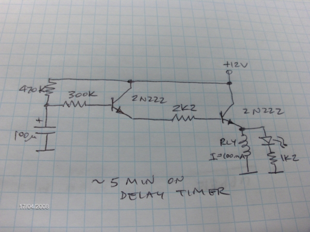

I was looking for a circuit myself for a 5 min on delay timer for the car to use with relay that turns on O2 signal conditioning circuit for fuel economy. Since I didn't find one I designed my own, using 2 transistors 2n222, few resistors, 100u electrolytic cap and relay. I'll post the circuit later.
(I noticed the post date after I replied :):eek:
Here is the circuit.
hmmm can't seem to insert or attach a picture of diagram? maybe..
