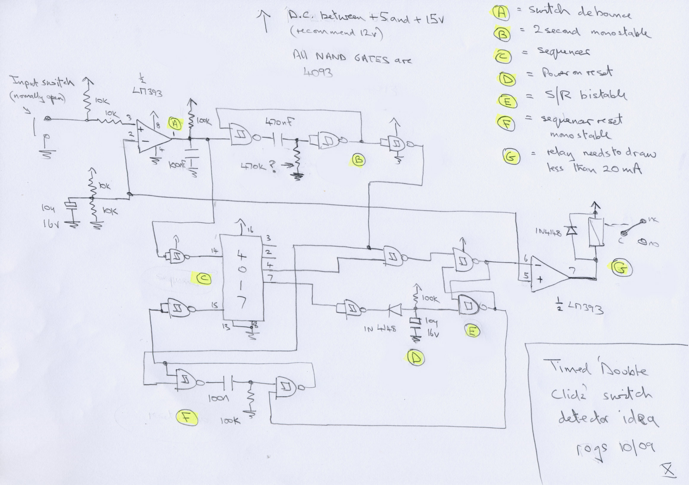

I need to create a latching output from the 'double-click' of a momentary push-button switch, but only within a fixed time period, say 2 seconds....
Here's the idea :
1/ A momentary switch is pressed once.
2/ After pressing the switch, a timer starts, with a duration of 2 seconds.
3/ If no further switch press is detected within 2 seconds, no further action is taken - the output of the latch remains OFF / low.
4/ If the switch IS pressed again before the 2 second time limit is reached, the output is latched ON / high.
5/ A further single switch press simply resets the latch output to OFF / low.
I've thought of using bistables, AND gates & counters, but am now really pulling my hair out....
Any ideas would be greatly appreciated.
Thanks all :)
Dont pull you hair out..:)
Look at monostables, either a mono ic or a 555 timer configured as mono.
1st push starts the 2sec mono, 2nd push gated with mono output.

Yes, a single momentary switch must be used to start, stop & reverse the motor as needed.
I mentioned 'easy bit' in reference to the H-bridge motor driver IC I'll need to use to control the motor - these are usually quite simple to use & normally have a direction input pin 1/0.
The hard bit (for me) is getting my head around the logic required to perform 2 tasks with 1 SPST switch - each operation having 2 states...
Forward & Stop : single push start - single push stop
Reverse & Stop : 2 x pushes in <2 seconds - single push stop
I suppose a small microcontroler / PIC could be the realistic answer..

The simplest way is to drive the flip flop into a 4017. The first output is gated to a change-over relay. The second output keeps the relay on and is gated to a FET.
The third output keeps the relay on but turns off the FET. The fourth output turns off the relay. The fifth output turns on the FET. The sixth output turns off the FET. The 4017 then cycles again.
You will need 5 gating diodes. With this circuit the relay will be closed before power is applied. You also have a delay before changing the relay.

Variation on colin55's idea to use a 4017 as a sequencer attached. Haven't tried it, but I think it looks OK.
You could probably rationalise the gates a bit -I just prefer to use the Schmitt trigger inputs on the 4093s -keeps the monostable outputs nice and clean.
Not as elegant as the PIC option, I'm sure -but nice and simple for a 'one off' project! :)

Thanks a milliion for taking the time out to draw this schematic - I'll certainly get it breadboarded up tonight & will let you know how it goes..
I count 11 x Nand Schmitt's (3 x 4093's), Johnson Counter plus Comparator - quite a lot of veroboard work to be done, but I'm game for anything ATM :D !
