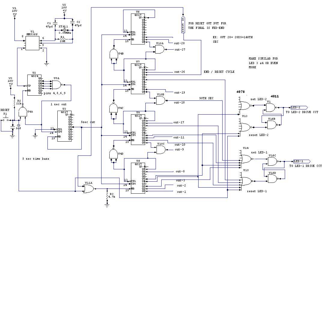

you can make use of a pulse with 1 sec interval together with 4017 counter to count 25 cycles ( you may need 3 counters) and reset at 26th, it start to give a logic high in the sequence of its out puts up to 25, you can use disired out puts, to latch and reset the LEDs.
example if you use 1st out put to "set" and 6th one for "reset" the interval would be 5sec. the same way you can wire for the rest of the LEDs. every LED needs a latching logic that can be done using 2 input NAND gates.
depends on your total time for once cycle of operation, i assumed its 25 sec, you can design it, since you have 5sec steps, you can use a high freq oscillator and deviders to get accurate 5sec pulses and then use it to drive 4017 counters.
i can futher draw you the circuit if you provide more information like a timing diagram. you can use very simple logic as i said to complate this project rather than a microprocessor.

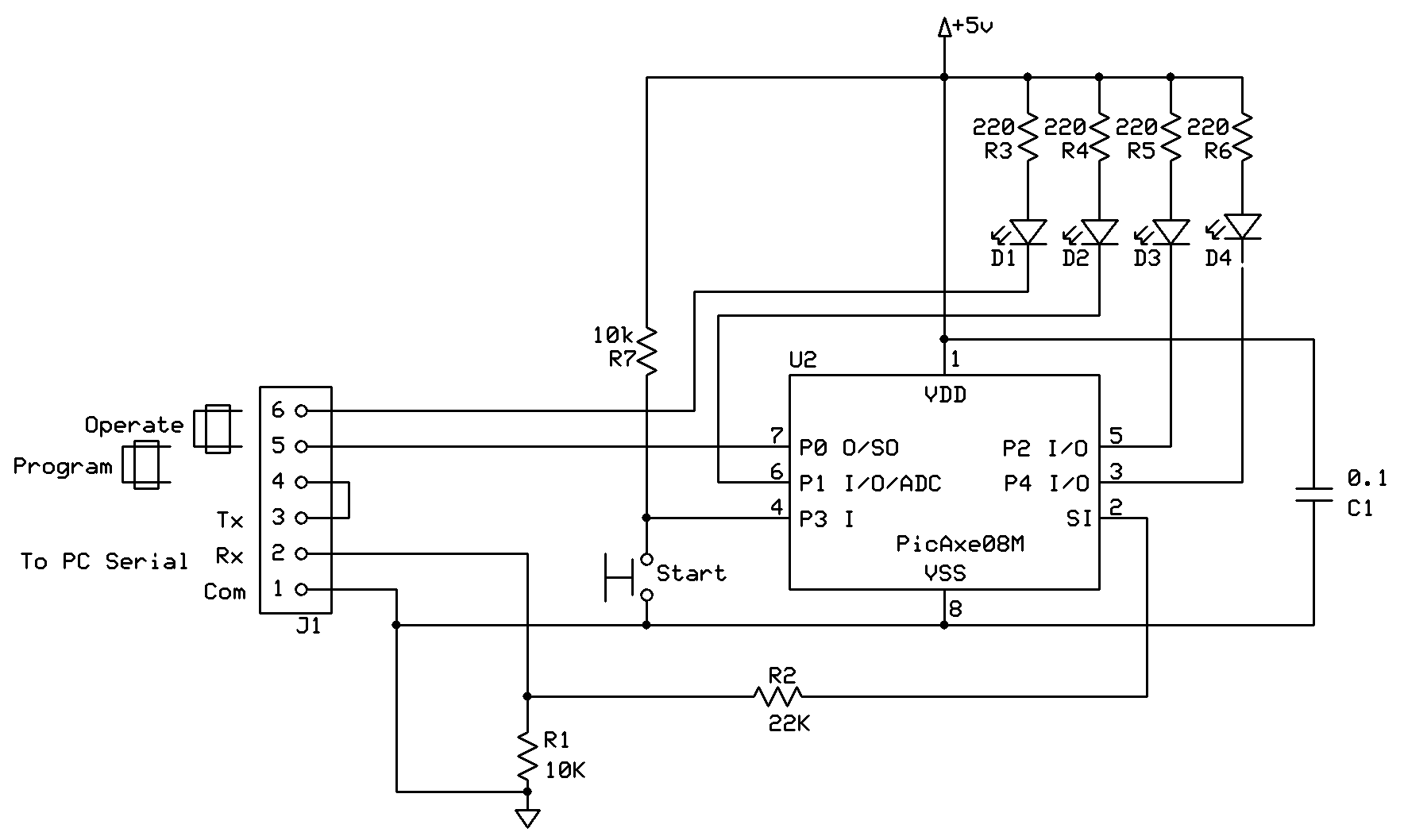

I would recommend a PICAXE 08M microcontroller. It's a Microchip PIC with a built-in BASIC interpreter. The 8-pin chip is cheap, about $3.50US. It has one dedicated input pin, one dedicated output pin and three pins that can be inputs or outputs. (for you: 1 input and 4 outputs) The BASIC program editor is free to download. Extensive manuals are also download-able. Programming hardware is a 3-wire serial cable and 2 resistors. The normal 4MHz clock is by an internal RC oscillator, that can be tweaked. Not as accurate as an external crystal, but from the sound of your requirements you are not looking at NIST Atomic Clock timing. ;)

just to confirm, at a certain instant, only one LED is ON? i mean there is no overlap? also when one is turned OFF the same instant other one will be ON ( no delay?)except at the begining? i have almost sketched the circuit, wish to draw it and post it soon.
circuit for the project
am attaching you the circuit of the timer, at the final stage i didnt complete for LED 3&4 not to make it so difficult for you to read. you can easily know how it should come and you can configure even more out puts as you wish. also you can make it for more time by simple addition of ICs.
the circuit can be discussed as three parts.
1) time base for 5 sec out puts- gives one pulse in every 5 sec
2) a series of decade counters, that will make logic high in its out puts one by one when the pulse is received. out-1 to out-36 in this case ( total maximum time- 36x5=180 sec)
3) set re-set latch for LED drive circuit with 8 input for set and reset, can be varied as per requirement.
i hope you can understand how it works, if you assemble it as appears it would work great.
for any information about the ICs used you can access the following site and search for the datasheet. all of them are mostly available, or even you can use similar types.
Datasheet catalog for integrated circuits, diodes, triacs, and other semiconductors, view
any problem or question feel free to send.
best of luck
razeen

OK, I have to throw in the alternative. One 8-pin DIP vs sixteen 14- and 16-pin DIPs. This is why I started refreshing my 30 year old BASIC programming skills, and using these microcontrollers.
Ken
