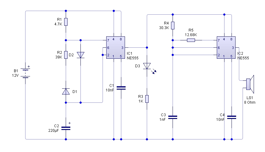

I want to make one of these:
http://www.thinkgeek.com/gadgets/electronic/79be/
any ideas on how it can be done, i guess i can get all the bits from RS but what would I need, could it be done with a 555 timer or a simple pic chip and a speaker?

I have found this
This would surly do exactly the same as the circuit available? simply by changing R1 and R2 and the capacitor?

Yes, use the calculations given on the page. Connect a piezo buzzer from pin 3 to +V, use a very high duty cycle (98%) and set the frequency for 0 .005Hz.
It could be done with minimum components using a PIC with internal oscillator to generate a pseudo-random number generator to vary the delay between a few minutes and about 5 minutes, Then generate a very short chirp.
It would probably drive someone mad enough to destroy it when they find it though.
Here is a circuit I built to scare off the neighbor's cats (many, too many...).
If you go through and change the timing components it should work the way you want. Might even be good as is, because you can hear this, even though it was intended to be ultrasonic (depends on temperature). You can use a 556 instead of 2 x 555s, and should be fine on a 9 volt battery, mine is plugged into the wall, and had a 12volt walwart.

If you want to get devious, use an LDR (light dependent resistor) that prevents it from working when there is light. They will have to find it in the dark... There are a number of inexpensive kits that do this.

I have not got a pic pregrammer,although that would be the best way forward.
So I guess using 555's is the best way forward.
