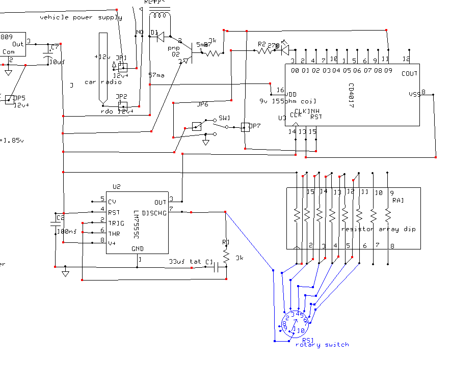

I made a really basic LED night light for my kids. It consists of a few LEDs a 9V battery and a switch. I would like to integrate some sort of timer so that it goes off after an hour. Can one of you electronics gurus point me in the right direction? I can solder and use a volt meter but other than that I am pretty ignorant in regards to electronics. Thanks! Mike
Use a low-power Cmos flip-flop that drives a Mosfet. The Mosfet drives the LED. The flip-flop is flipped from a low-power Cmos timer.

use a 7555, not the 555. if you need to just cascade two astable timers together where one
triggers the second one
here is an unproven schematic for a long duration timer.Desgned for an automotive app using a relay but a Mosfet would be less current drain.
the rotary switch could be eliminated just use one large resistor. use quality TITANIUM caps as they don't leak as bad (internal ot external, more stable for this app)

Nobody makes a TITANIUM capacitor. You mean a Tantalum capacitor.
I misspelled big time!!
