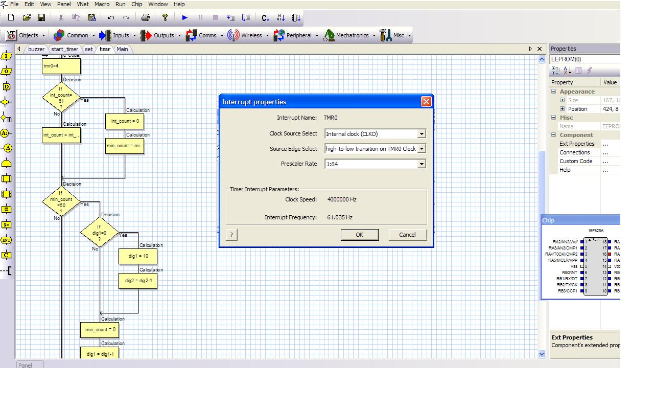

Here is what I have so far...
Preload TMR0=4
Each intterupt increments int_count
If int_count=61, 1 second passed
Increment min_count
If min_count=60, 1 minuite passed
Decrement Digit
Some math regarding 10's overflow
After about 40min the timer looses accuracy to about 1.5sec
Cameron
Cameron
That's could be because the interrupt frequency is 61.035 Hz and you can only count 61 per second.
That means that you will lose a second every 61/0.035 counts.
So every time your counter (which counts to 61) does (61/0.035) 1743 counts, you will lose a second. That's about every (1743/60) 29 minutes.
That equals about 1 - 1.5 seconds every 40 minutes ;)
