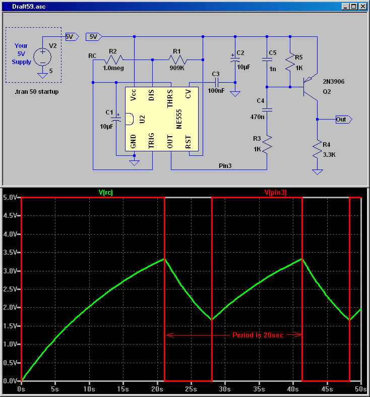

timer555 to generate single pulse

Hi, I have did a good research, I am able to do the time delay by 20 sec, but after that I need a signal for 1ms or so. Right now I what I get is 50% ON and 50% OFF cycle. Am still on researching. Will something help with 3timers.. ?

For that extreme difference in On and Off times you might want to use two 555s or a 556. A 20 sec astable triggering a 1mS monostable.
Ken

I would take that route or use a 555 astable for the 20 seconds and let that drive maybe a 74123 for the one shot.
Ron
Why use an 8-pin and a 16-pin chip (only 1/2 used) instead of two 8-pin chips, or one 14-pin chip? Or maybe one 8-pin PIC?
Ken

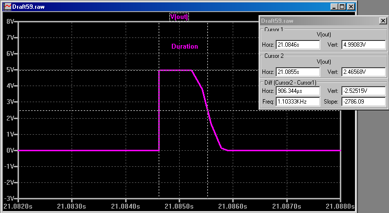

Here is my suggestion:

This would be a piece of cake with a PIC, but I'm not sure if the OP has had any programming experience. His objective is still conceivable with a 555 timer, so that might be easier and faster for him despite more components involved.
LTSpice. Free download at Linear.com
