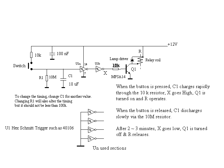

I have attached a timer that could be adapted for 30 min or 60 min.
This is a variant on the timer I built for my garage door opener. It keeps the light on for about 3 min after the door has been opened or closed.
However, RC timing only provides approximate timing. eg. say 30 +/- 5 minutes.
If you want a more accurate timer, then you would need a counter as someone suggested.

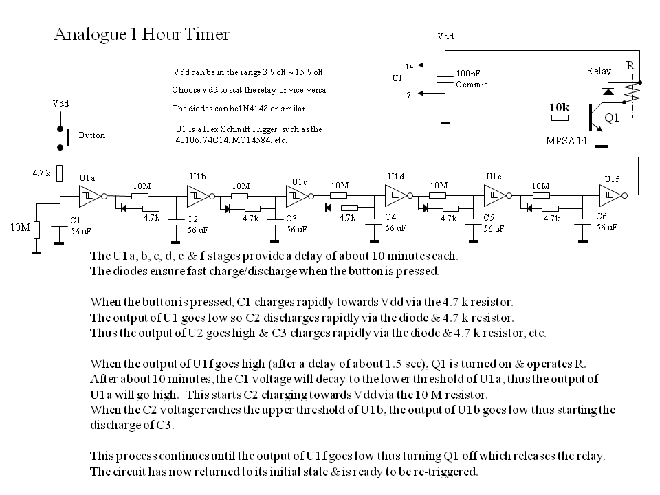

Here is an analogue timer that will operate a relay for about 1 hour.
If you want it to be 30 minutes, change the capacitors to either 33 or 27 uF.
