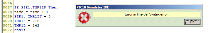

EDIT:1/ Changed the 'comma-space' to 'dot' and it compiled. See error gif

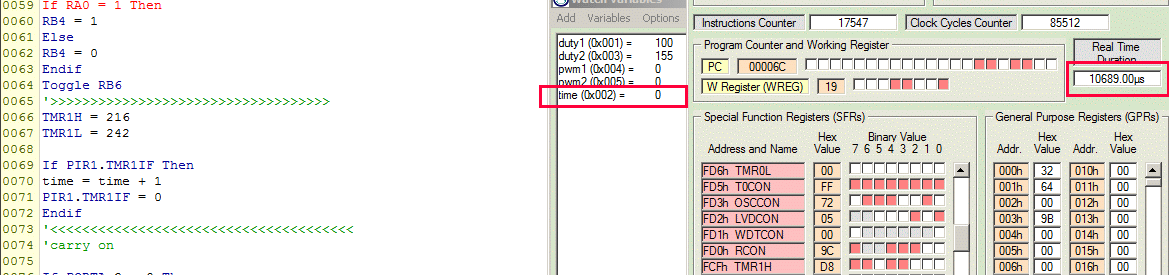

2/ Only when the TMR1H/L was placed before the IF, would it enter the numbers into the SFRs

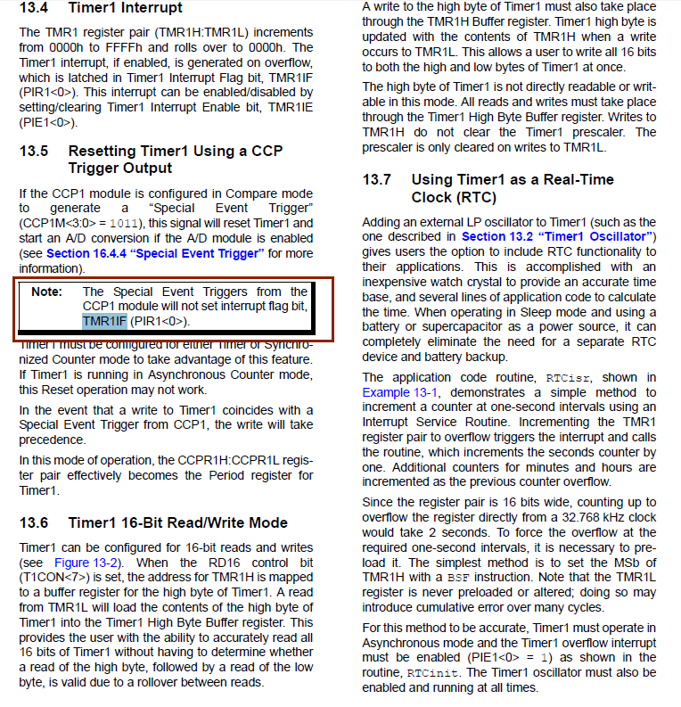

3/ Is the TMR1 GIF relevant?

In the TMR.GIF in post#21 you can see that nothing appears in the TMR1/2 SFRs also TIME does not increment. In the full program I have now changed the variable TIME to PACE.
