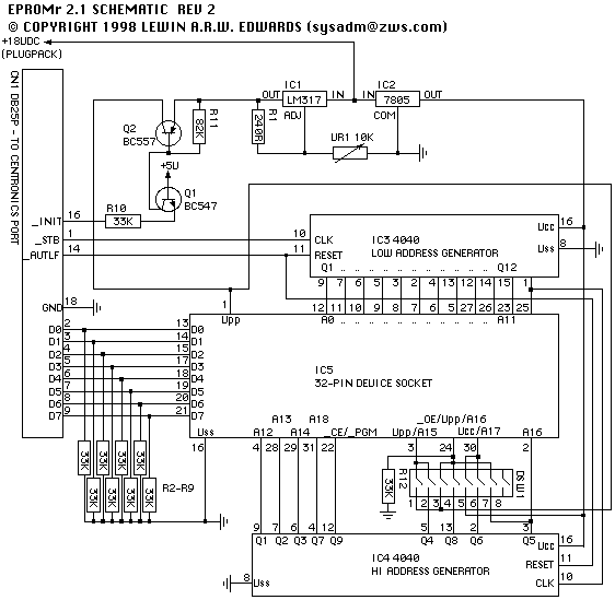

Thanx for the info.usually pics have their own intenal pullups..as for the eprom i could find much info ,except the info that most eprom programmers have either pullups or pulldowns .As a matter of fact i came across a design which makes use of pulldowns on data..the author justifies by explain some problem with parallel interface;he also adds that use some brands of eproms may require pullups in place of pulldowns.
wonder if u have come across any eprom pgmr design with pullups or pulldowns.take a look at attached file.

Re: pics usually have internal pullups
But the PIC doesn't connect to the port! - the 7407 does!.
Also, PIC's only have weak pullups (software activated, not present unless the PIC is running and they are activated) on certain pins, usually just PortB. So it's not relevent at all.
It's no good chasing round trying to find a circuit that conforms to what you want, as you quite rightly say - some people add pullups, some add pull downs, some add nothing. I've previously listed the only pins which require pullups, anything else is just down to the personal preference of whoever designed it.
If you're building your own programmer, and using a PCB, leave room for either pullups and pull downs if you wish, then you can try it with or without them.
wonder if its just a preference
thanx.But no chasing around work............i said that i came across a few circuit,and not just one ,a couple of them.
if it were an option or prefernce; the author of that circuit would not have asked us to switch from pulldown to pullup.If that were a matter of just preference.....the author would not want us to do that extra bit of work just for preference.there's goto to be more to it.since data is being read randomly in my case ......i think i should try the pullups.what say u?
Re: wonder if its just a preference
Try them and see, it won't do any harm!.
