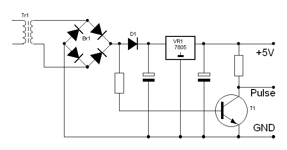

How could I implement a circuit that gives me a TTL 0 (or 1) when the mains are at zero crossing (to avoid using an A/D converter)?
Zero-crossing is simple to do, and certainly doesn't require an A2D, here's a simple method I posted ages back.
Thanks a lot!
I'm sure that I'm missing something, but in the above circuit, when you are at zero crossing, you get a clear 1. However, don't you get an intermediate voltage (between 5V and perhaps 1 V) all the rest of the time? If so, when a digital circuit (like a µcontroller input) will detect one or zero depends on the transition threshold of this input. How do you handle that?
