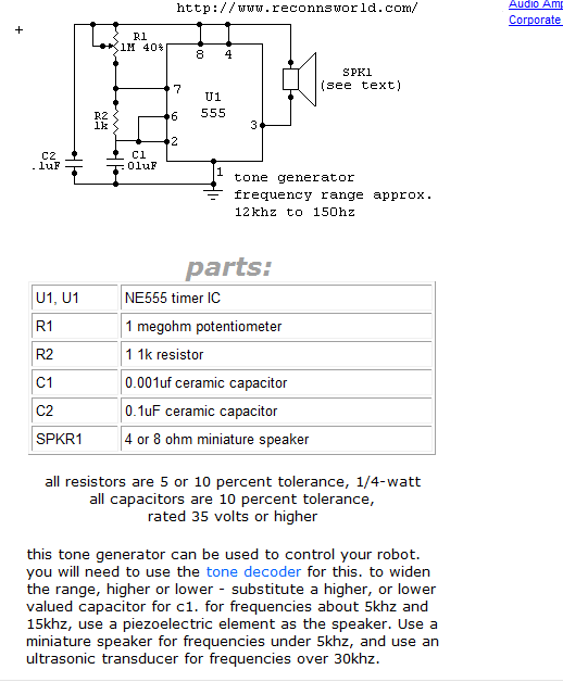

I found a tone generator on the net--see attachment that i want to use as a threshold sound.
My question is, can i apply a sinewave from a different source as well that varies from 200mV Peak to Peak to 0v to this circuit which is already oscillating with a pre set tone.
I want to vary the tone with the sinewave source when it is triggered, the sinewave is constant at 200mV until triggered & depending on how much it is triggered it can drop as low as 0v.
Is this circuit ok to drive a small 8 Ohm speaker as well?

The circuit you posted has a very large FLAW! There should be a polarized, 47uF to 470uF capacitor in series with the speaker, otherwise, the power consumption of the circuit will be horrible, the 555 will get hot, and you may even cause the speaker to bottom out in the cone's range of travel. Speakers should always driven with AC only; so the capacitor is needed to block the DC component.
The circuit does not have a battery nor a power supply to power it.
The current into an 8 ohm speaker is too high for the 555 IC.
The 555 IC has a square-wave output like a buzzer and does not have an input for your other signal.
You can try to insert a common-source or common emitter transistor between the rail and the 1MEG resistor. Then feed the signal into the transisotr's gate or base. You'll have to know something about analog design and how the timer's frequency network operates. But you might be able to pull it off.
I'd use a 64Ω speaker (if I could get hold of one) and a capacitor.
What voltage is the power supply?
If it's 6V you'll probably be all right just connecting an 8Ω speaker to 0V via a capacitor.
pin 5 is the control voltage pin which can be used to vary the 555 output but that is a very poor circuit which does have a lot wrong with it..........

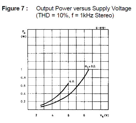

I have a TDA2822M IC that i would like to use to drive my single 8 Ohm speaker with a single input into the IC.
I noticed on the IC Data sheet -Output Power versus Supply Voltage- (see attached image) that with a 5v supply the power output is roughly the same rating as my speaker .25W
Is it safe to apply more power into speakers than what there rating says.
For example can you safely exceed this limit of .25W a little if need be.
Thank You
A tiny speaker with a power rating of only 0.25W is garbage.
The TDA2822 amp has horrible 10% clipping distortion when it has a supply of only 5V and a load of 8 ohms. Its distortion is 10%.

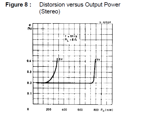

Sorry for the ignorance, could you explain how you got 10% distortion from the Data sheet--Attached

Hello Codan,
You have been showing the curves from the datasheet for the little TDA2822M (8-pins case), not for the larger and more powerful TDA2822 (16-pins case).
With a 5V supply, an 8 ohm load and operating as a stereo amplifier (not bridged) the output begins clipping at about 240mW. The output is extremely clipped (a square wave) with 10% distortion when the output power is only about 300mW.

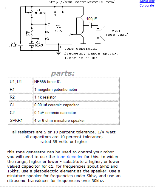

I'd add a transistor to the output of the 555.

why bother with a decent speaker or amplifier for a tone generator?

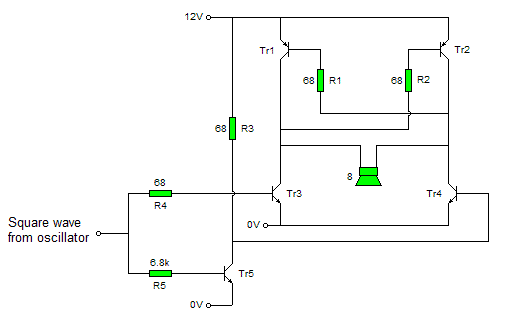

A crappy tiny speaker with a power rating of only 0.25W is garbage. He might as well use a much better speaker and raise the supply voltage so that the amplifier has some power output.
It depends on how loud it needs to be?
A 0.25W speaker is quite loud when driven from the circuit I posted. It'll probably burn out if it's left running got too long though, if the supply is 6V the RMS power in the speaker will be 2.25W but for short bursts it'll be fine, I should know I've done it before. :D
This circuit is easier on the speaker but it drives the speaker with much less than half the power of the previous circuit.

If you want it to be really loud then use this circuit but make sure the speaker can handle 18W.
