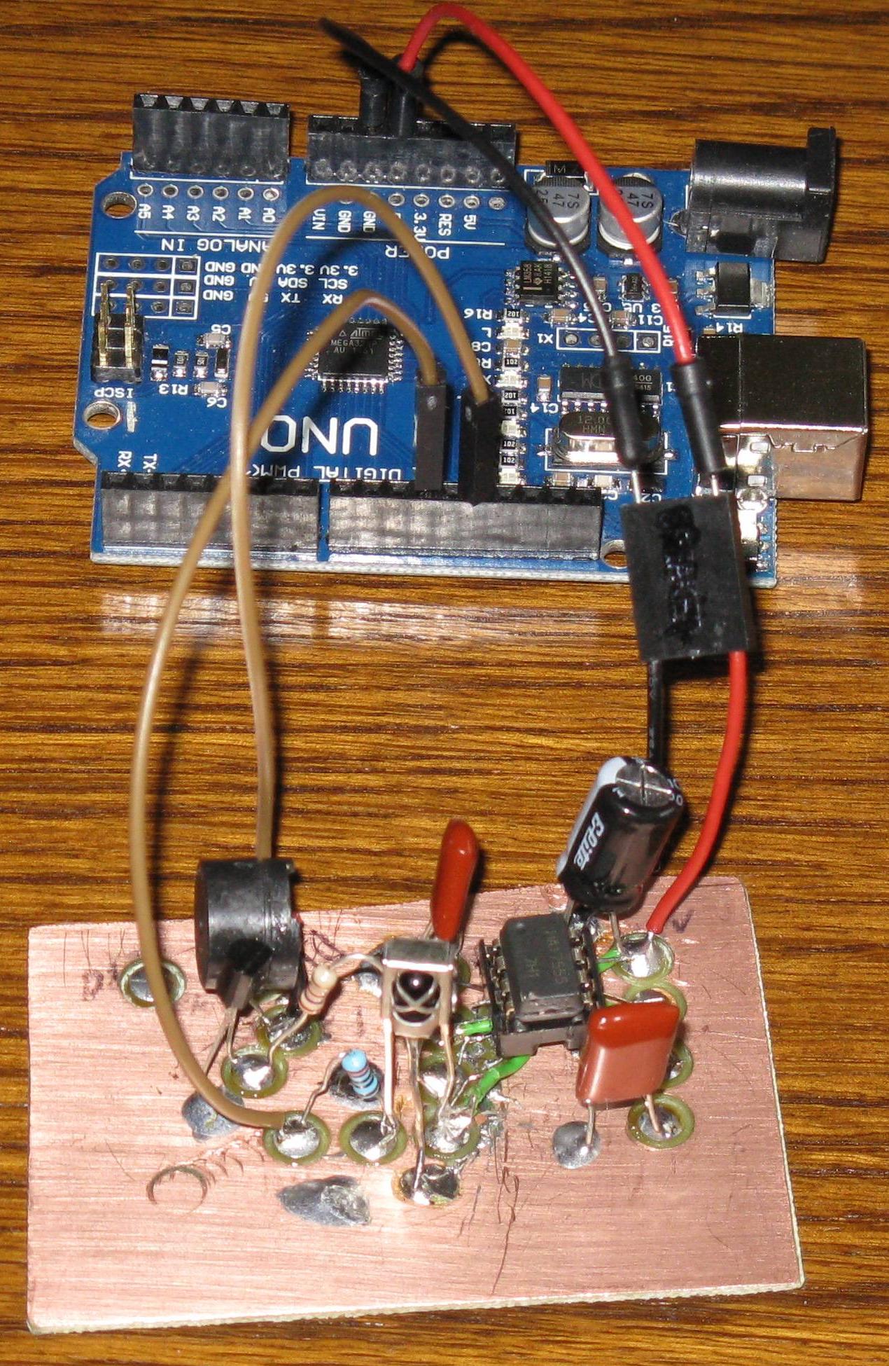

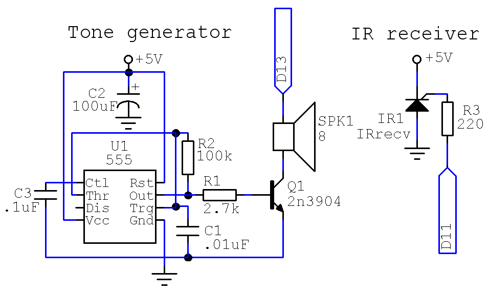

Wrap up. Played with libraries but gave up. Solution for me is not to use 'tone'
Gated a 555 astable osc. to do what I wanted. At this point I have a Uno sending Morse to another Uno (for no good reason) reliably at 120 wpm. Poor code, I know, but here is the sender and the little circuits.

// interrupt problem avoided by removal of 'tone' function
// replaced by providing a 555 oscillator and switching pin 13
// 28-4-15 19:00 GMT+1

I wanted to see if the 'island' technique would work for DIP sockets.
I made two rows using a 3mm diamond glass cutter. This to anchor the 8 pin socket.
It works but poorly. The 3mm is the outside diameter of the drill. The inside island is maybe 1mm.
This is enough to hold a pin but it is very easy to overheat the pad and lift it.
This is ok if you still have enough pads to hold the socket in place. I lost one.
I then used enameled wire to hook around each socket pin and bring out to a 6mm pad.
Fiddly but can be done. 100k resistor (pitch) has been replaced with 15 turn pot.

IR Rx looks like a Buffered Rx with AGC that needs a clean supply . Does it work? What pn?
