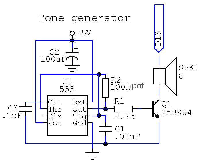

This is working well. (yea!) I think I'm happy with this. IR gone. Random stuff by itself, not toggling with setting a pin. New improved randomseed.
// send random Morse code
// uses external oscillator. pin D13 high to trigger.
// has improved random seed
#include <Arduino.h>

A version not needing an external oscillator - just a sounder and resistor in series if you don't want to draw 40ma intermittently. I used 220 ohm.
// uses tone/notone instead of external oscillator.
// Plug speaker to Analog pin8 and gnd. Use a resistor or pot in series if you want to. I used 220 ohm.
