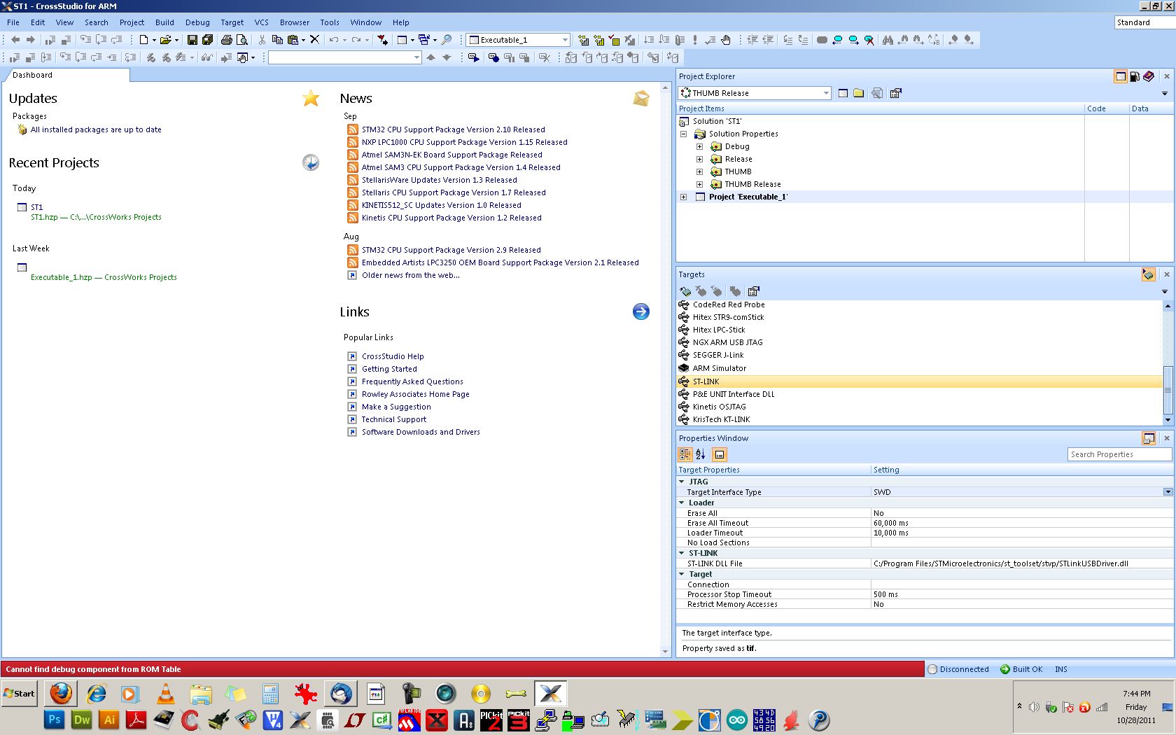

Hey i just got that stm32F4 board a few days back and havent had much time to play. i couldnt get it working at all in crossworks. Even with the correct tools installed. I get a USB error. Sucks!...
Since i have the weekend off i dont have to sleep much. Hence i can play with it now. So ill give you guys some updates real soon.. hopefully good news :)
So far kind of good news... no usb error but yet another error...

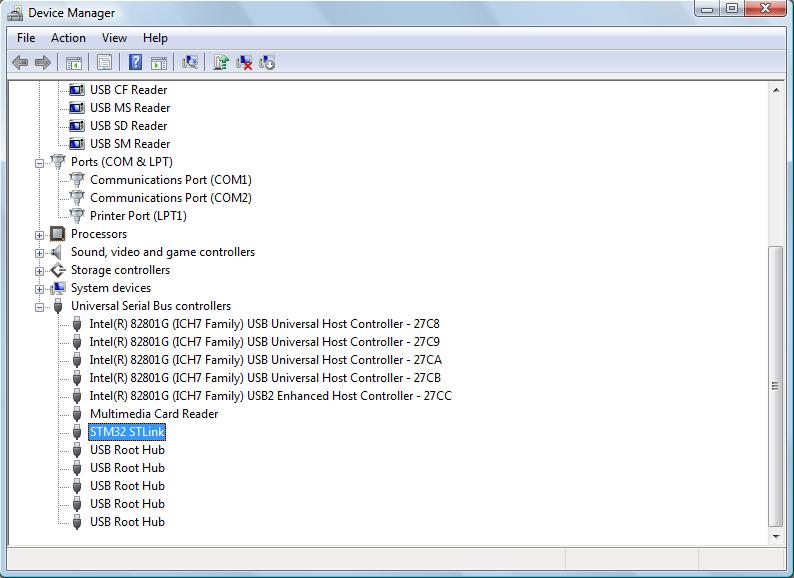

Mike It looks like this in mine

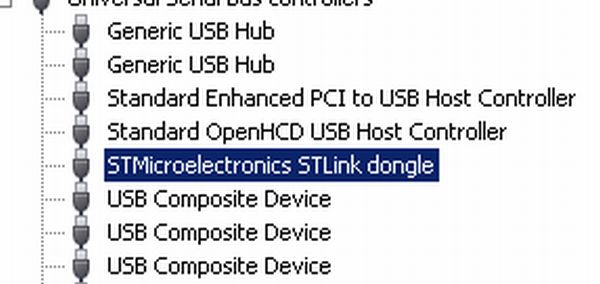

Mines is different... (Sorry for late reply, i didnt get a email on new post :( )
dongle-jpg.57954
Jason did yours work mine said that at first but it was the wrong driver? When I got it to work it shows up as posted
Or let me rephrase that it shows up as a ST-Link dongle till it loads the driver after that it loads the right driver from the start. when plugged in
Ok I still get the DEBUG error thing but i think i know why. Crossworks supports the STM32F407VG but these are different they are STM32F407VGT6.
Perhaps thats why it cant find the ROM stuff. Its too new for crossworks. I know its not the ST-LINK itself because i can read/write to the MCU using the "STM32 ST-LINK Utility" program itself.

OK here is a conversation with Crossworks support.
ME:
Jason Lopez, Oct-29 03:47 am (BST):
I just got my hands on this demo board and it has a STM32F407VGT6 on board. I see your software supports the STM32F407VG but when i try to use the demo board with ST LINK it says :
Cannot find DEBUG component from ROM table.
Any thoughts on this? Thanks
Rowley:
Michael Johnson, Oct-29 08:49 am (BST):
You'll need to use the 2.1.2 release a preview is here
Downloading it now and will give my update shortly

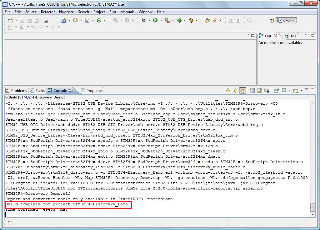

Here my first go with TrueStudio so far so good it complied
