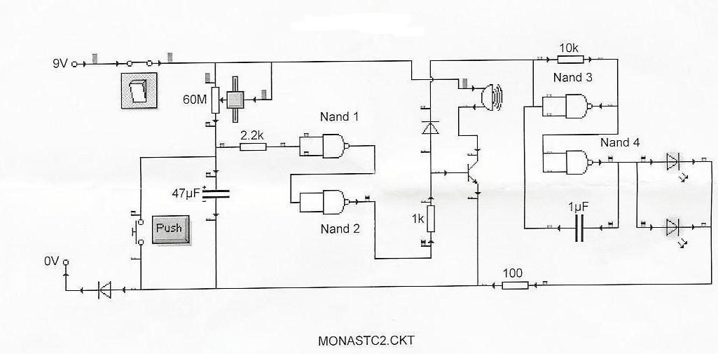

I will very grateful if you can help. I am making a toothbrush timer for my electronics project. I have done a Monostable circuit using a variable resistor, capacitor, push to make switch and 4 Nand Gates. I have used an IC instead of the 4 Nand gates in my real circuit but I can’t remember what the IC is called. It goes like input, input, output, output, input, input, voltage etc.
The buzzer goes off after 3 minutes, which tells the user to stop brushing. But I want to add a counter circuit to the toothbrush timer so the LEDS light up one after the other with a delay of 30 secconds, so the user can see when the time is about to run out. i plan to add 6 LEDs which will add upto 3 minutes. Can anyone tell me where I have to connect the counter? is it posiable the timing of Leds change at the sametime as the buzzer if the variable resiton is adjusted. And do you have any ideas that I could add to the Toothbrush timer? I can add a diagram if you need one?

Here is the diagram of my timer circuit, i need to add more stuff. any ideas?

For a start I would add a couple of resistors, one in series with the pot (and where will you find a 60M pot?), because if the pot is turned to minimum resistance pressing the button will short the supply out. Also I would add a current limiting resistor in series with the switch, shorting the 47uF out with the switch will burn it's contacts quite quickly.

you could use the nand gates in a 4011 IC or the NOR gates in a 4001 IC (the two input pins are connected together so it has the same affect)
i have, however, created an alternative to your circuit, useing a 555 timer IC and a 4017 IC. The 555 feeds a pulse into 4017 every 30 seconds(ish), which advances by one count to light the next LED. when the sixth LED is lit, the buzzer sounds, and the counter is frozen on that output, until you turn off the counter.
this may be of no use to you at all, but it may give you some ideas.

i have tryed making the circuit, but it keeps on blowing up for some reason? can anyone help me ?

i assume you are mocking up the circuit in Crocodile Technology, like the first one.
two things.
one, go into space (or options) and then logic. Enuse that the selected option is '4000 Series Logic'. Also change the 'supply voltage' to 9v (or whatever you are using).
two, ensure you are using a 4017 IC, not a decade counter, and the enable pin is inverted. (if you can only get a decade counter, reply, and i'l show you what you need to change)

Thank you :D , I inverted the enable pin and it started to work.
