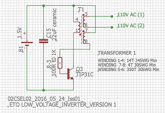

For clarity here is the circuit and winding instructions. The dots on the windings show the start of the winding. All windings are wound in the same direction. A wide range of transistors, including MOSFETs, will be suitable. The capacitor provides decoupling and also allows more energy to be extracted from the battery as it discharges.
spec​
ERRATA
(1) Change transistor from TIP31x to TIP35x
(2) Change winding 1-4 from 24SWG minimum to two parallel windings of 24SWG minimum

I have noted your comments and advice and would request MrAl to furnish the 2 transistor converter circuit for our reference here.
Let me also inform you that I have already made a JT using 3E25 core mentioned above with 400T of 30 SWG as Secondary, 15T and 60T with 26SWG and it is able to drive 3W 220V LED bulb. However, I am not very happy with the brightness of it. There is yet another JT circuit which I have made with the 77 toroid with 300+T using 30SWG, 4T using 22SWG and 14T using 24SWG. This also lits up the same LED bulb. The brightness of the light with both the two circuits seems to be same. To me, it can be useful as a night lamp but I want to increase the intensity more. I have tried using 2n2222, TIP41C, BD139...all give me fairly the same result!
The first circuit using 3E25 core gives me around 30 volt pulsed DC output without any load from a fuuly charged 1.5 volt AA 2100 mAH NiMH battery where as the second circuit gives around 50 volt output. I am not able to increase the voltage beyond this. I know that the LED bulb brightness will increase when the secondary output reaches 110 volt. I will try the above circuit suggested by SPEC and revert with my results. Please find the screenshot of the circuit for "Super JT" attached here.
However, any suggestion as how I can achieve 110 volt output from the secondary coil will be appreciated.

A capacitor across the inverter supply might help. Try a large aluminum electrolytic (470uF or above) in parallel with a 100nF or so ceramic capacitor if you do not have a single large ceramic capacitor.
When the capacitors are fitted. measure the voltage across the battery when the inverter is running under full load.
Try putting three more 1.5V fully charged batteries in parallel, giving a total of 4 batteries to see what happens.

I have just had a look at the TIP31 data sheet. It seems to be unsuitable for your application: Vbe, Vcsat, hFE. I will have a look for something better.
UPDATE: The TIP35x (where x is A, B,or C) would be much better choice for a common cheap transistor. Other transistors would be even better though.
