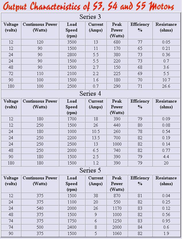

20 Ohms seems high for a 36V 180W motor? I'm guessing that rating may have come from a marketing department?
I just had a brain fart, in the chart below how would one set a current limit based on a known peak power, a set voltage and know resistance?
P=I*V
or
P=I^2*R
For axample, the first motor 680W, 12V, 0.05Ohm
p/v= 680/12 = 56.67A
or
sqrt(P/R) = sqrt(680/0.05) = 116.62A
I'd probably err on the side of common sence but remain wiereded out :)
