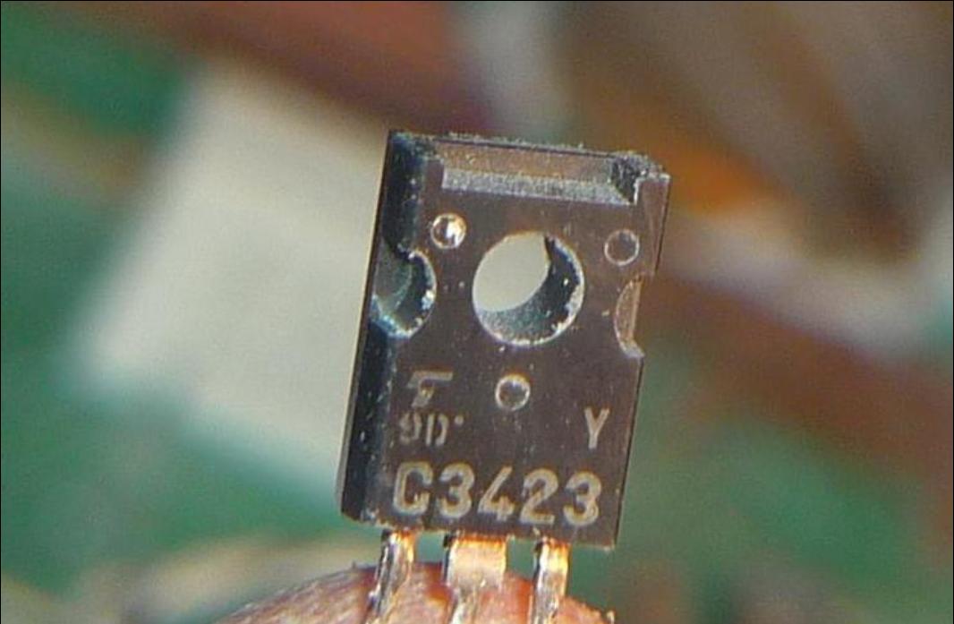

While cleaning my car I removed My Amp. Sony eSupport - XM-405EQX - Model Home .

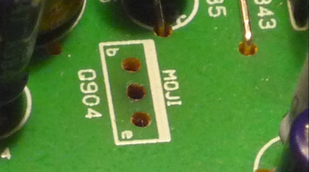

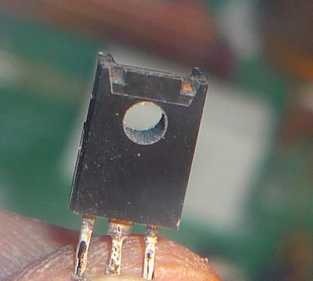

I heard a rattle comming from inside, so I quickly finished cleaning the car & brought the amp in the house to take a look.
I opened the back of the amp & a lil gizzmo fell out !
So I Googled the gizzmo & learnt it is a NPN Transistor made by Toshiba.
A YouTube crash corse on Transistors sent me searching for a C3421-Data-Sheet & the XM-405EQX Service-Manual.
Well I found em & attached linx to both, in hopes that it'll aid in getting me a lil direction as to questions I have about the NPN & buying a new one. I'll post thee exact questions a little later, cause I have to go to class rite now, but I really wanted to get this much past the mods & posted.
Hopefully these will help the next guy who's looking for em, so that he won't have to search as long & as hard as I did !

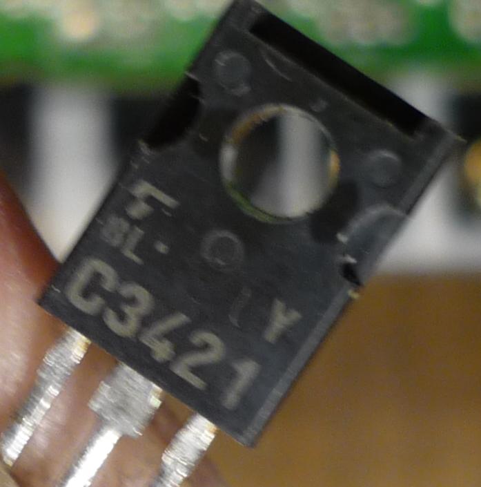

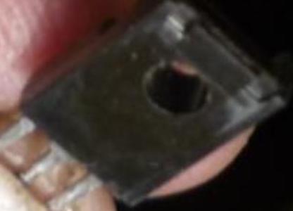

Photos of what I'm workin with & where I'm at:
**broken link removed** .

Some transistors have the part number abbreviated, the full part number is 2SC3421.
I doubt you'll be able to buy it from RadioShack who don't sell many components these days. You should go somewhere like RS Components, in the US you have Digikey.

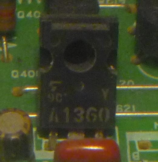

I came across a Toshiba "2SC3423" (I've attached a Pic & Data Sheet).
I was hoping you'd tell me whether it will surfice as a replacement to the "2SC3421"
(As long as it's a good working part).
Also:
Will it deliver too much power ? or
Will it only deliver whats asked of it ? (Although capable of supplying more).
What do you think?
Have you compared the two datasheets?
What are the similarities and differences?
2SC3423 as a replacement for 2SC3421
I'm probably wrong, but I think I see quite a few differences, & although I'm sure you don't need me to, I took the liberty of listing them below. However back to my Uneducated guess.
I can tell You that I really don't know, but if I was stranded on the moon & My rocketship needed a 2SC3421 but all I had was a 2SC3423 then I'd definitely want to give the 2SC3423 a try.
Because from what I can see it looks like it will do the same job with less overhead less overheating less stress on the part.
But in all ernest, I really don't know & it would only be a guess!

The maximum collector current is to low, you ned a transistor which can at least take an Amp.
The other ratings are fine, the voltages are the maximum ratings, you can use the transistor at a lower voltage.
The Hfe (gain, the current amplification factor) is the same, in general, you can substitute with a slightly higher gain but it shouldn't be lower.
The transition frequency is, the frequency when the gain falls to zero, normally you can substitute with a higher frequency but not lower, although in this case it's only an audio amplifier which needs to amplify up to 20kHz so 120MHz is overkill and it's fine to use a slightly lower value. If this was an RF amplifier or the transistor was a much lower frequency then it would mater.
The capacitances are parasitics which only mater at high frequencies, a higher frequency transistor will generally have a lower capacitance.

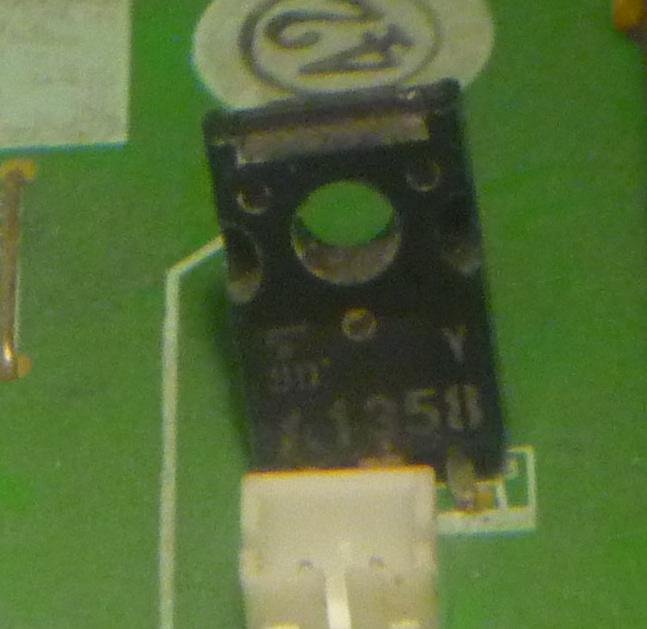

#4.Find one inside the Sony 1000 Watt amp, that I have here for spare parts!
(Which by my inspection of their spec sheets comes out to none, & that I do not understand. I mean how can a amp twice as powerful not have a transistor in it that can handle half the job it was designed for?)
Please tell me I'm wrong

Neither the 2SA1360 nor the 2SA1358 will do, I'm not going to go through it again, look at the datasheets and you should be able to now see why. I explained how to you how to do this before, if you didn't understand anything I said in my previous post then do ask.
Why don't you get a debit card?
#1 There are two possible solutions:
Most banks will do that, if your credit rating isn't high enough. I don't have a credit card either. I shop online with my debit card.
Ask a friend or family member, with a credit/debit card to to buy it for you and you pay them back.
#2 Not likely
RadioShack are useless when it comes to components.
#3 Not likely
Most electronics repair shops when out of business when cheap imports made most electronic items cheaper to replace than repair. This is why it's often hard to get spares - the Internet is the best place to look.
#4 It's possible.
Lots of smaller transistors can be connected in parallel to make a larger transistor. The chances are though, that the power transistors will be mounted to a heat sink which could be off the PCB.

The normal courxe of action would be to obtain them as spare parts from Sony, it might be more expensive, but at least you know they are right.
You also need to ensure you replace everything that's faulty, replacing just the output transistors often causes them to blow again - as you haven't cured what caused them to blow in the first place.

From somebody whose been in the service game for longer than I wish to remember........
Faced with your dilemma, I would install that transistor.
It is of the same general type, most likely a driver. The current used will most likely to be well inside the max rating, voltage ratings are similar.
Power up briefly, initially, and then check for any sighs of overheating. Massive overheating indicates a fault nearby e.g. other devices.
If it works ok, congratulations youve just fixed it!
That's what I tell my people when they are trying to repair a TV with a blown Line Output Transistor
A LOT always blows for a reason. Loptx going faulty, flyback caps gone low, flyback caps dry jointed, PSU running too high, line driver stage smoothing caps gone bad and, lately, LOT becomes loosely attached to it's heatsink over time due to poor thermal coupling by the cheap and nasty approach by Chinese manufacturers to use nuts without spring washers....
Every time a LOT blows there is a reason behind it. Gotta find the reason first otherwise you will blow up heaps of LOT's trying to fix the set.
