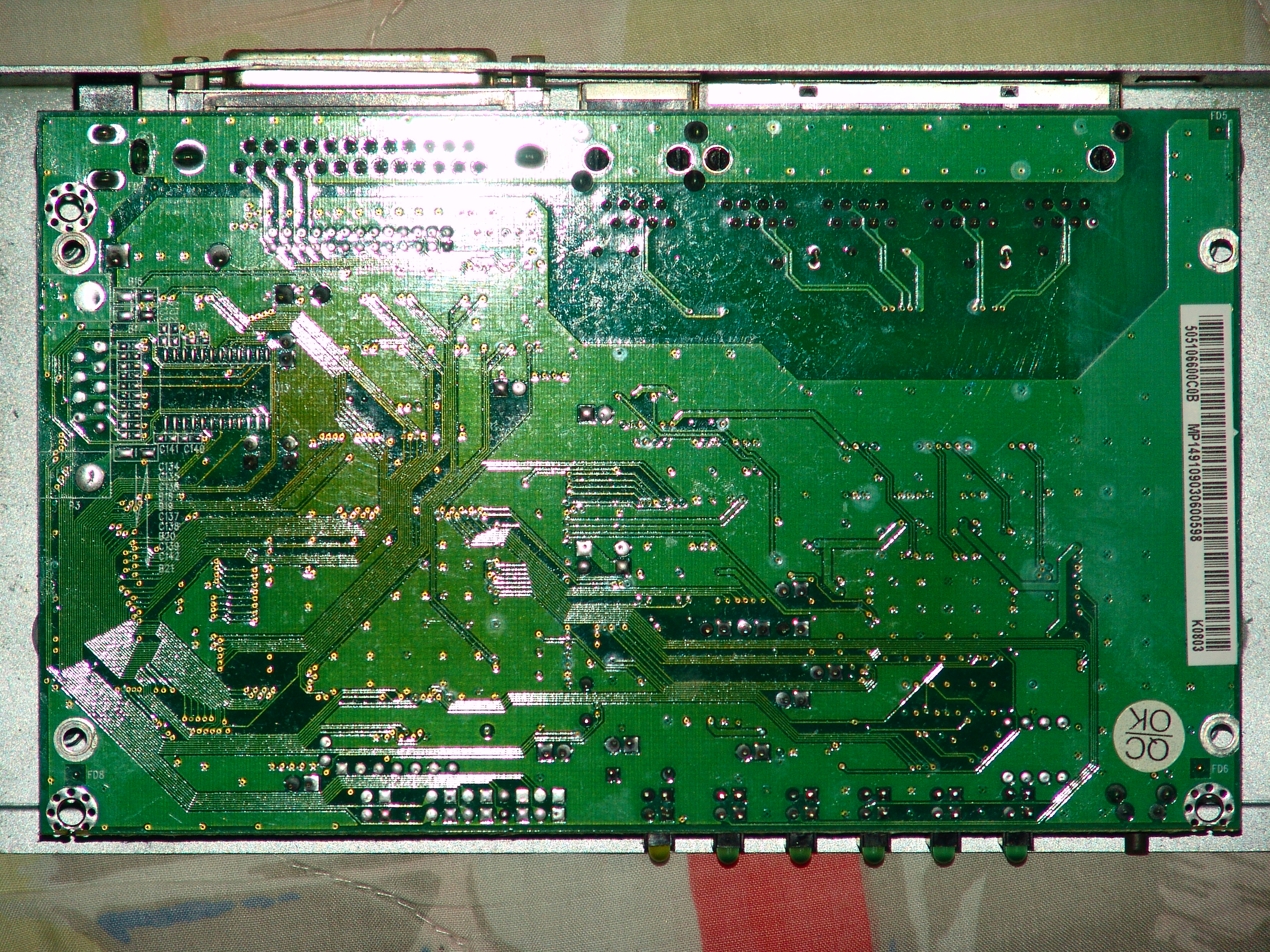

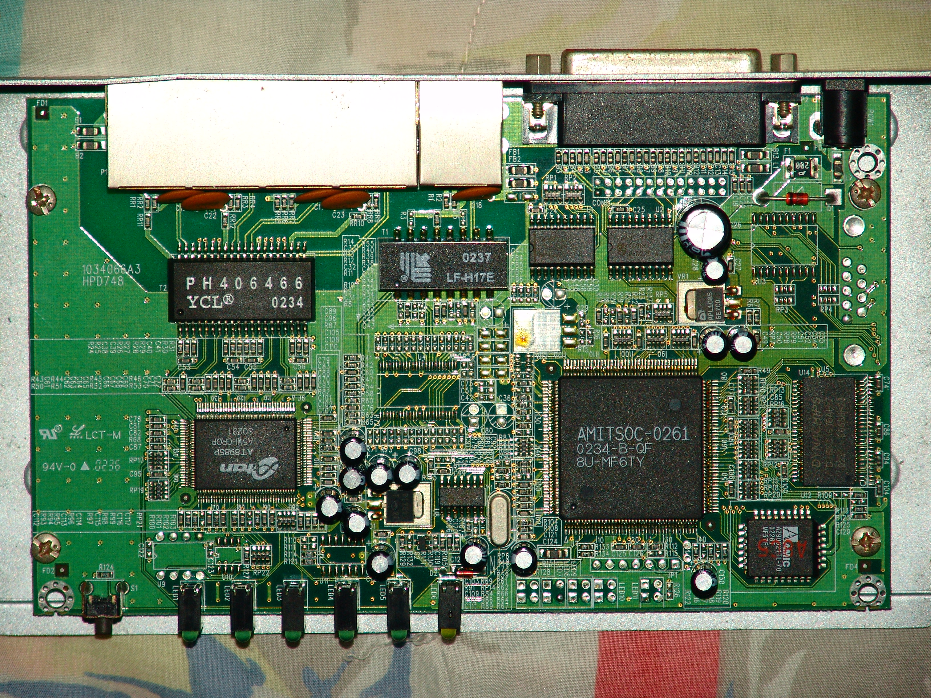

Attached are front and back pictures of the circuit board:
http://www.rvnet.ath.cx/xieliwei/router/DSC04825.JPG
http://www.rvnet.ath.cx/xieliwei/router/DSC04826.JPG
