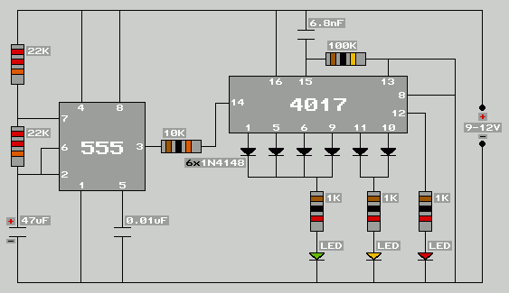

A traffic light controller is just a finite state machine. The easiest way to do it is to draw the state diagram and then you can directly convert the state diagram to code for a micro or some vhdl.
For example, the start state is 1 light red, the other green, then go to yellow, then red, then pause, then the other goes green, etc.
Something like this?

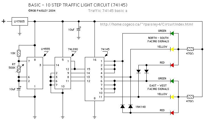

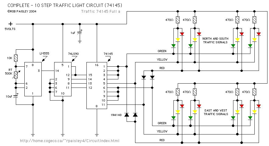

I have Lots more!

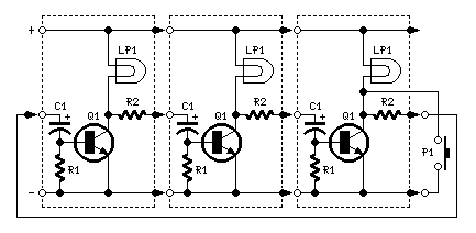

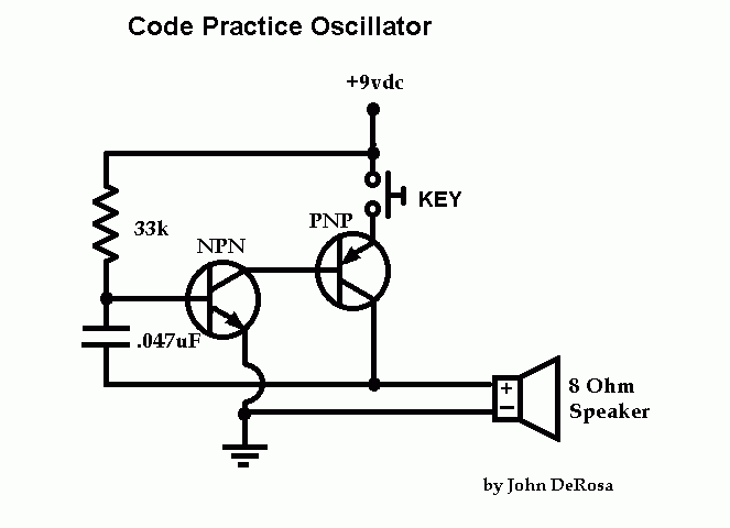

The Code Practice Oscillator is more popular beginners project.
