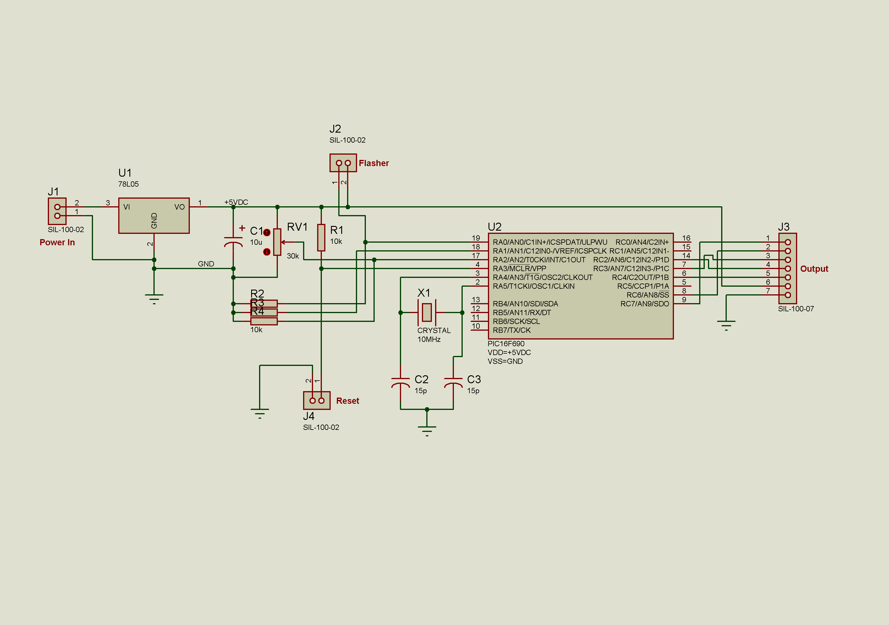

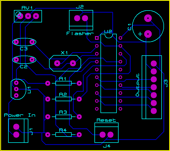

Traffic Light
Here's my traffic light controller. I've attached the layout, the schematic, the source code, and in this message, I'm putting the HEX code that was compiled by flowcode. The first three outputs control the N/S lights and the last three control the E/W lights, so its a 4 way light setup.
