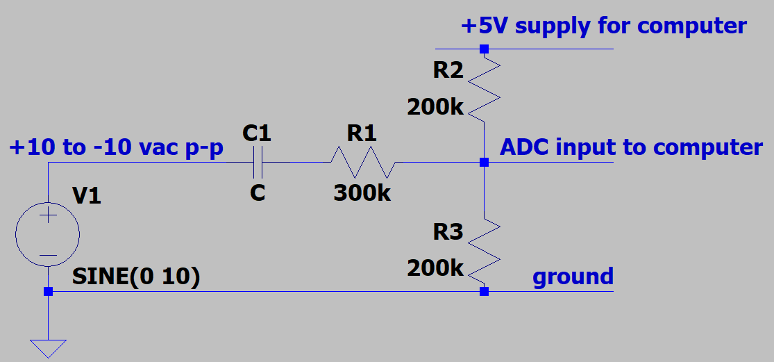

I think it is just scaling down but here is the task regarding AC signal sensing attached. Again sorry for the hassle but this is my first ever electronics project and I have a poor background of electronics.

The PDF seems to have little or no relation to your original question?, and actually explains what you need to do - simple attenuator, and add a DC offset.

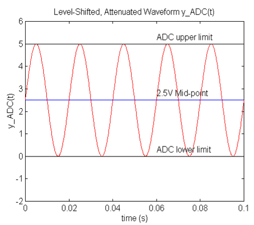

After a quick look at the .pdf; it looks like they don't want a "rectifier". They just want the computer to read voltages in the +/-10 volt range. The computer can not read that so a circuit is made to convert -10 to 0, 0 to 2.5 and +10 to +5. (remember the computer can only see 0 to 5V)
There are several ways to do this.
C1 strips off any DC from the signal to measure.
R2, R3 causes the ADC input to want to go to 2.5V or 1/2 of the supply.
R1 & (R2//R3) makes a voltage divider. (reduces the voltage down to what the computer can read)

From the .pdf your posted: The -10 to +10V signal gets changed to 0 to +5V for the computer to read.
119389
I agree. making a multimeter and the assignment don't really agree. Anyway, I mentioned how making an AC voltmeter might work.
Do what's asked.
