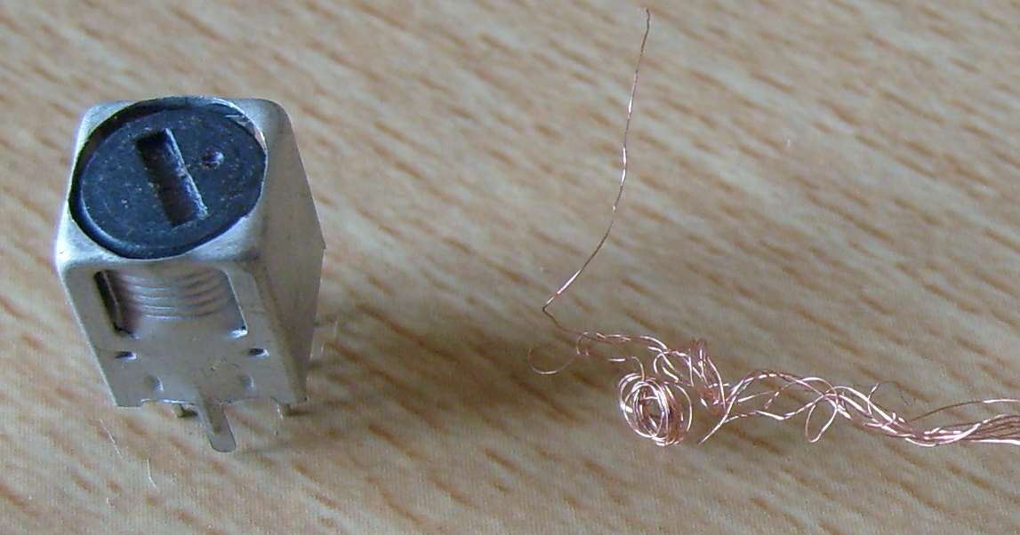

I have taken a pic of the transformers I have. They are impedance matching transformers for a piezo buzzer of some kind, rated at up to 125KHz. The datasheet doesn't mention the power requirements. It simply says, 125KHz, 2.2mH minimum, Q = 80 and turns ration 1:20.
It seems to me like you're not aware of the enamelled copper wire that is used for winding. Thin layer of enamel is painted on the copper wire so that they're normally isolated on each layer of winding, so an explicit separation between primary and secondary is not actually necessary, but they do.
I wasn't aware of that no! It's very clever, and very simple. In this case it is I think just plain wire, could be wrong, i've taken a pic.

That transformer looks an IF can from a radio which won't be large enough, you need a ferrite E core used in a SMPS.

Yes I can see this transformer isn't up to the job. It was logged on Farnell as a piezo impedance matching transformer without much detail, it was worth a look for £1.40, but not much else.
Hi transistor495. I took a picture of the wire and zoomed in. It is indeed insulated copper. Very thin stuff! :)

It looks like a piezo microphone transformer.
