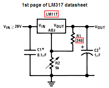

one more thing i have used 330 ohm as R1 instead of 240 ohm i think this wont be a problem
Then when the load is disconnected the regulated output voltage will rise.
An expensive LM117 can use 240 ohms or less for R1. An inexpensive LM317 is supposed to use 120 ohms or less for R1.

nikhil arora said:
so what is the overall effect in using 330ohm instead of 240ohm
The output voltage from the regulator will rise when there isn't a load.
The setting of the pot will also need to be higher.
An LM317 needs 120 ohms, not 220 and not 330 ohms. An LM117 (more expensive) can work with 240 ohms.
Lots of circuits on the web have the same mistake.
On the very 1st page of the datasheet for the LM317 is a circuit with a 240 ohm resistor and an LM117.
The LM117 costs more than the LM317 because its operating current (that goes to its output) is half as much, therefore the resistor can have double the value.
That's what is so confusing. You say one thing, the data sheets say another. Who do we believe?
AllVol said:
Who do we believe?
Even ON Semi and Texas Instruments got it wrong on their copy of National Semi's LM317. I believe in National Semi because they invented the LM317.
i got it guru so we will use 120 ohms from now cause i am using lm317 from ST.
i belive more in forum then in datasheet
You still need to calculate the value of the other resistor which is about half of its value when using 240 ohms.
