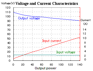

Simple inverters do not have voltage regulation. The load current causes the output voltage to drop.
Here is a 70W simple square-wave inverter for Japan where the mains is 100V. The inverter's voltage is 109V with no load, 100V with a 40W load and only 90V with a 140W load.
