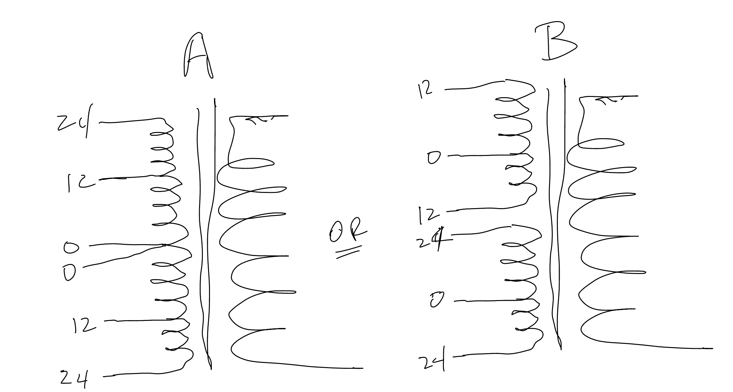

I got a transformer that is 25-25-0 plus 12-12-0, both em are dual output i need to know if i can just connect em in this same order to get more voltage ik, at the end the total watts will be the same, and if that's possible, is this safe?

If the transformer is in fact 25-12-0-12-25. then a big NO.

Like?? Both of their grounds???Post the resistance across the outputs. What is the resistance between the two 0V secondaries?
Well i did the continuity test (ig thats what its called and it seems the zeros are separate as there was no beep from the multi meter, so its BVersion A cannot be adapted for various voltages, version B can be added to get higher voltage. Measuring resistance from zero to zero on A will be a short, on B it will be infinite.
There is none, i check it with my multimeter and no continuity beep eitherPost the resistance across the outputs. What is the resistance between the two 0V secondaries?
I am learning alot today it seems, but im sure my transformer isn't this onedo you mean like this? This is 1:2 centre-tapped. That won't give 35~40 out on each leg.
Its isolated i confirmed it just nowWe are trying to determine if the 12 V windings and the 25 V windings are galvanically isolated. What is the resistance between one of the 25 V wires and one of the 12 V wires?
a) multi-megohms or infinite
b) anything else
