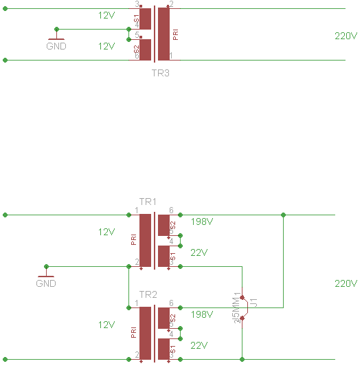

I am building chemelec's 220V inverter. It requires a 12-0-12V to 220V output transformer. Short of buying one thought I would try something.
I have two identical 650VA transformers from identical UPS's. The transformer windings are 13.3V / 220V and 24V. By connecting 12V to the 13.3V winding I would get 198 and 22V respectively making up my required output of 220V.
See the schematic below, is this possible or must the windings share the same core steel?

I think your idea might work. From a magnetic standpoint, there is no requirement that the output share the same core, usless the particular design requires it. Just try to turn up the volage slowly and monitor the levels. Also suggest you simulate the circuit if you can, just in case there's something we aren't thinking about. I can't answer your 2nd quesion because I don't understand it. If the output of a transformer changes with the load is connected/disconnectes, it means you're dropping voltage through the secondary resistance. I don't think it has anything to do with magnatizing current.
A possible problem is the difference in voltage due to normal transformer variations. This will generate a circulating current in the transformers equal to any difference in voltage divided by the sum of the transformer output resistances. That will cause the transformers to dissipate some extra power. Whether this is significant depends upon the amount of voltage difference between transformers.
As long as they are EXACTLY the same transformers, that shouldn't be a problem.

they are visually identical and come from the identical units. I do not know if they are electrically identical.
Been musing on this ..... is my thinking correct? The inverter will be driving two intermittant resistive loads totalling 340W (fridge and freezer in my caravan for a maximum of 6 hours road trip). As mentioned the two transformers are rated at 650W continuous. Assuming 15% losses and that both appliances are on simultaneously it means that only 31% of the transformer capacity will be used. Would this be enough headroom for the heating, would not think that the transformers would be that different.

Certainly if they have identical output voltages. But I believe two transformers of the same design and construction can still typically differ in output voltage by ±5%.

I would imagine that identical cores, with the identical number of turns of the identical wire, would be a LOT closer than 5%.

They would be virtually identical. I have strapped the outputs of identical transformers in parallel to double the current rating with no problem. Good makers do a winding check on them so you know they have the same number of turns.
The big problem would be if the two transformers were the same "part number" but made by different manufacturers. Then you will really have problems because the number of winds probably won't match.

it should work well, but ensure the windings are in proper sequence..
the 'end' terminal of winding 1 connects to the 'start' terminal of winding 2 etc... reversing this produce no voltage...
