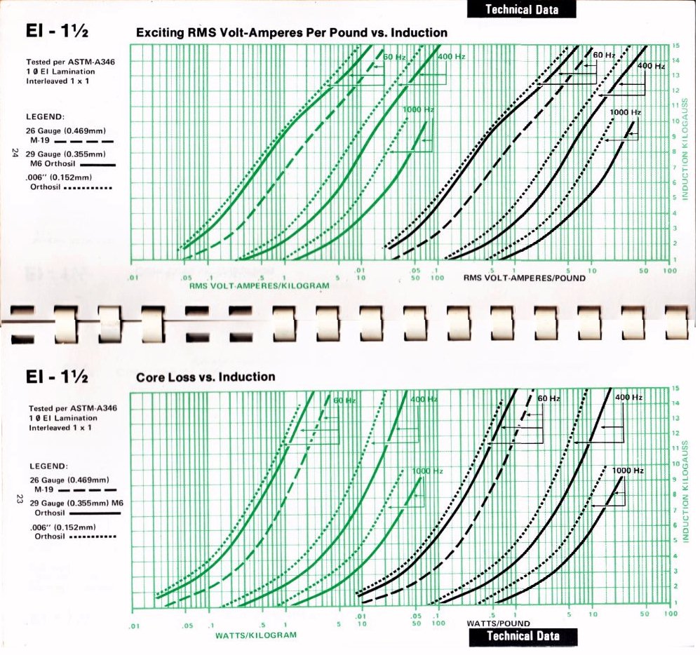

Actually, the way this is estimated in practice is the Watts Per Pound vs Excitation curve is examined for the level of B used for the transformer. That curve gives the wattage for every pound of core material used in the design and for that particular level of B. Obviously you have to have the curve for your particular type of core material or can find it online to do it this way. You then calculate B for the design and then read off the curve the watts and multiply that by the weight in pounds and that gives you the estimated no load power consumption.

I could not find any data on line for a core EI138 of any type of material (didnt look real hard yet though) but i do have data for a core EI1 1/2 (that's EI one and a half) which may be close to the size you are talking about. I have data from about the same period for core types M19 26 gauge, M6 Orthosil 29 gauge, and Orthosil 0.006 inch. I also have 10KGauss data for a few other cores on hand, but anything else would have to be obtained from the manufacturer.
Basically the procedure would go something like this...
1. Using the dimensional data, calculate the weight
2. Using the voltage and frequency, calculate the flux density
3. Find the right curve for the right material at the right frequency with the same interleaving
4. Look up the exciting volt amperes per pound
5. Multiply the pounds times the value found in step 4 above
If we dont know and can not get the right material data, we can estimate but from the data i have i can already see that with different materials we can see a difference of 2 to 1 in the exciting volt amperes, so it would be best to know the material type too.
If we can not get the right material data i can give an example of a core using some known type of material (with published data) if that would help.
Thank you, MrAl

Hello again,
[see attached data for magnetic laminations]

Well, it's simple algebra, and after all the question was how to calculate the power and such so i presented a method for doing it. If you dont want to do it that way that's fine. Of course we need the data, and we need to know the material as i had said before. This information is always available at the time of design. Certainly if you cant get the data or the material type then you're stuck with measurements, and measurements are always a good idea anyway of course.
Sceadwian:
Yes there is a way to estimate it, and that's what i'll show more explicitly now.
colin55:
We assume here he is working with line frequencies, and sine waves. A butt stack is handled via an appoximated stacking factor, as are different interleaves such as 1x1 or 3x3.
Whomever:
For the people more interested in this, take a look at the attachment.
Also, air gaps are especially helpful when used with cores that have to carry DC current to prevent easy core saturation.
