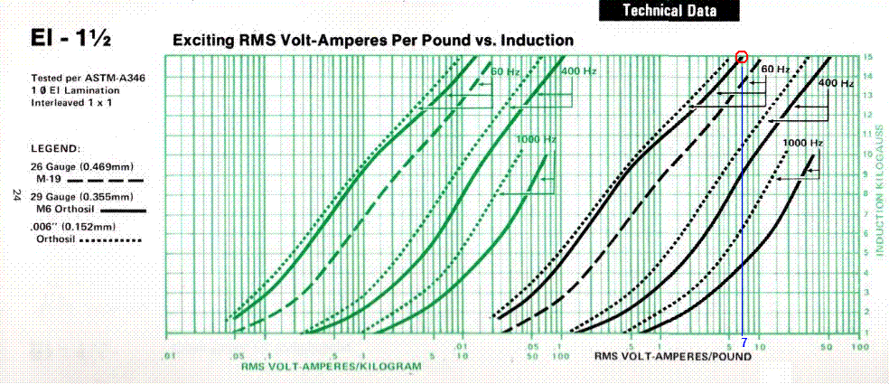

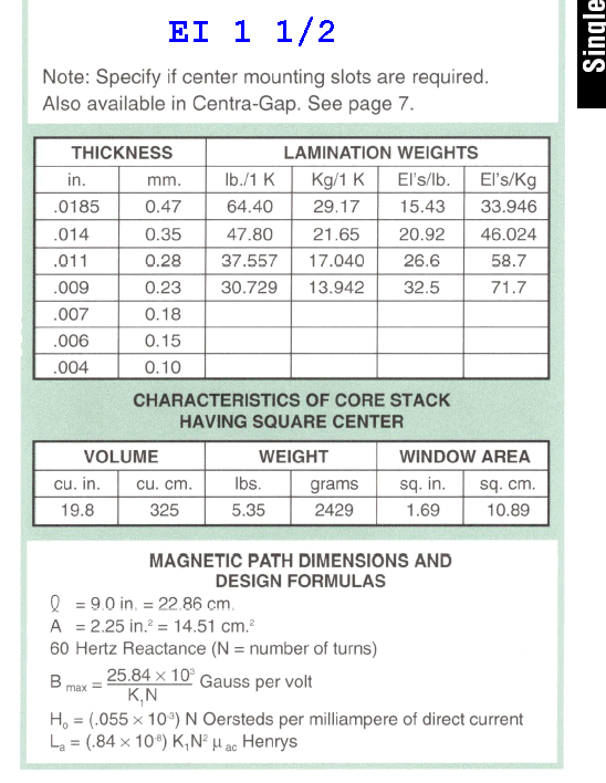

Lets start with a standard EI 1 1/2 core. The data for this core is attached as two drawings.
We'll also start with a square stack, which is going to be 1.5 inches high because the center leg is 1.5 inches wide.
The stacking factor we will keep at a perfect 1 for now to keep it simple.

In this example:
E is 123, F is 60 Hertz, A is 1.5 inches squared (2.25 sq inches), and N is 212 so we get:
B=123*10^8/(28.65*60*2.25*212)
and after doing that calculation we end up with:
B=15000.67
which we'll round to 15000 Gauss.
Now looking at the data for the core, we see that for M6 material that curve intersects 15kG near the top of the graph (red circle) and following that vertical line down to the x axis we find it corresponds to 7 VA/Lb. Now looking at the other data for the core we find that a square stack weighs in at 5.35 pounds, so now we multiply that times 7 and we get:
VA=5.35*7=37.45
which is about 38 volt amperes.
So you see it's just a matter of doing one calculation and then looking up the final answer. The same could be done for the core loss using the other curve from one of my previous posts.

Another use for this kind of design process is so that we can compare results from one type of material to another. For the data given in my previous post we can quickly see that M19 would make a construction that would take almost twice the volt amperes of M6 by simply comparing the intersections of both of those materials and 15kG. The dashed line (M19) at that point is about twice as high in VA than the solid line (M6) so we might consider using M6 instead of M19. It's been a while since i priced these kinds of laminations, but M6 is probably more expensive than M19 so we'd have to weigh the options. At least we would have a method to use to think about this that results in some real life usable comparative data. Without it we would have to purchase two cores and do some measurements on both cores with windings and all...quite a bit of work if you ask me compared to doing a quick calculation and looking at a graph.

Now looking at the data for the core, we see that for M29 material that curve intersects 15kG near the top of the graph (red circle) and following that vertical line down to the x axis we find it corresponds to 7 VA/Lb.
You have confused the loss designation with the thickness (gauge) of the laminations.
Your red circle is on the curve for the M6 material with a thickness of 29 gauge (.014 inches), not M29 material.
M6 means .6 watts/pound loss at 15 kG, with the laminations cut so that the flux is half in the rolling direction, half at right angles to the rolling direction. This is what the M6 designation originally meant, but some suppliers are doing better than this today.
