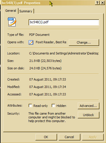

hi cz,
My d/s agrees with yours at 100mA.
Interestingly, right click on the 'other' d/s and note the properties dates.!!!!
ALL today, I suspect someone is playing games.:(

what? I did't copy n paste anything, i got that datasheet from net n i have no idea what you are talking about, what made u think that i copy n pasted it?
Ziddik,
You are correct. I am sorry I accused you of tampering with the PDF.
The properties does not show the date when the PDF was made, it shows the date it was downloaded and saved.
Maybe a kid at Philohome played with copy and paste.

So two questions: who do you think made this ersatz datasheet, but more importantly, why? Why would someone create such a misleading document?
(Document properties show someone named "kastillo" as the author, with a create date of 10/29/98.)
....[/b]? Why would someone create such a misleading document?....
Likely the same reason hackers try to break into your computer and foul it up. Some people get a perverse pleasure out of messing things up for others.
Don't rely on document properties (dates etc); they can be faked.
